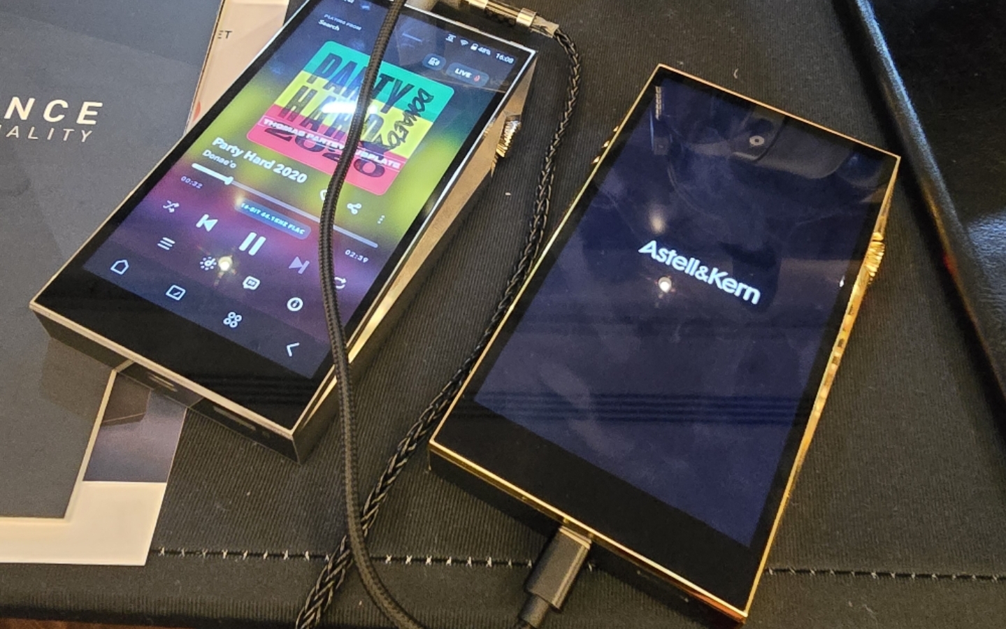

Astell & Kern SP3000 impressions
(Goodbye for now A&K)
I've loved the A&K SP series since the SP1000 up to the SP2000T. In fact the SP1000 was the first player that struck me as wow, now this is high end sound.
So I struggled to figure out why exactly I couldn't fall in love with the SP3000.
And so I listened, immersed myself in the music. Then it hit me, the SP3000 was the first SP series to not be holographic sounding.
The soundstage is big and has good depth don't get me wrong, but the lack of holography and air between instruments makes it sound less immersive and engaging to me.
Instrument separation suffers as a result giving it an impression that it is less detailed and congested. Mind you the detail is still there, it's just not as present, but like how a TV with poor contrast presents a picture, the finer details are harder to see in a dark scene.
The SP3000 also lacks bite which I suspect is due to the 4499EX (will have to see how the R6 Pro II and M23 sound). Eveything has a sort of softness to it affecting overall perception of clarity and dynamics. It's not like the SP1000 with an ethereal presentation, but rather like a blunted feel to the sound, it doesn't snap when it should. Doesn't help that the dynamics aren't class leading to begin with.
According to the store owner, a fellow audiophile, the Sp3000 returned to the old AK tuning, ie AK380 old. A more "cohesive" tuning according to some.
I recently heard someone describe a holographic signature as bright and artificially large. Which, as someone who has gone down the speaker rabbit hole, isn't how I would describe it at all.
I find that the airy feeling allows for the "out of your head" feel (with a suitably good pair of iems) that seemed to be the goal when I first started my audio journey more than a decade ago. And I'm happy that I have gear at or even beyond my wildest dreams.
But like how people are returning to analog R2R systems and the resurgence of vinyl, I guess people just long for a nostalgic tuning.
And that's ok. But till next time A&K
Ps: I was asked to try the HB1 which has the Sp1000 tuning and the holographic nature, while mild, was immediately noticeable. Guess it's really a tuning choice. Still unclear how sources are "tuned" to have a holographic sound.
Apr 24, 2024 at 12:23 AM Post #9 of 15
Astell & Kern SP3000 vs M15S
... It's has got to be a mismatch right?
But the fact is daps have gotten so good that the you no longer have to pay past $1000 to get flagship sound.
The super high end is now reserved for daps with special sound coloration options like R2R or vacuum tube options imo, which makes the SP3000 one of the $3000+ holdouts with only a "standard" configuration.
Tonality wise, the SP3000 is closer to neutral while the M15S has a slight warm tint. That said, this isn't a normal neutral vs warm scenario. The SP3000 has a soft presentation while the M15s is crisp and punchy but not harsh as well.
For classic dac + solid state Daps, being able to hear every detail isn't an achievement anymore, it's a low bar to clear around or below $1000.
That said, detail jumps out at you more on the M15S due to its combination of better dynamics, holographic soundstage and crisper sound. Not in an in your face way, but like peering out a window rather than looking at a picture, there is a better perception of depth and consequently, you are able to separate the layers better.
On the SP3000, you get a slightly wider stage, blacker background that makes it sound deeper in some simpler tracks but in complicated/busy tracks it's clear the instrument separation is worse due to the lack of a holographic soundstage making it sound congested at times.
Bass is thicker and goes deeper on the M15S which I enjoy more, but unlike on the DX260 the SP3000 doesn't sound tighter due to its soft presentation.
Mids are a similar case where the M15S has more body to the sound but remains crisper than the SP3000.
Treble wise they are pretty similar but the SP3000 has a more natural extension despite both having a softer presentation.
Dynamics is a complete bloodbath, M15S vs SP3000 is like HDR on an OLED vs an LCD. Powerful vocals and instruments like trumpets come through strong, bold and crisp while they are soft, polite and subdued on the SP3000.
