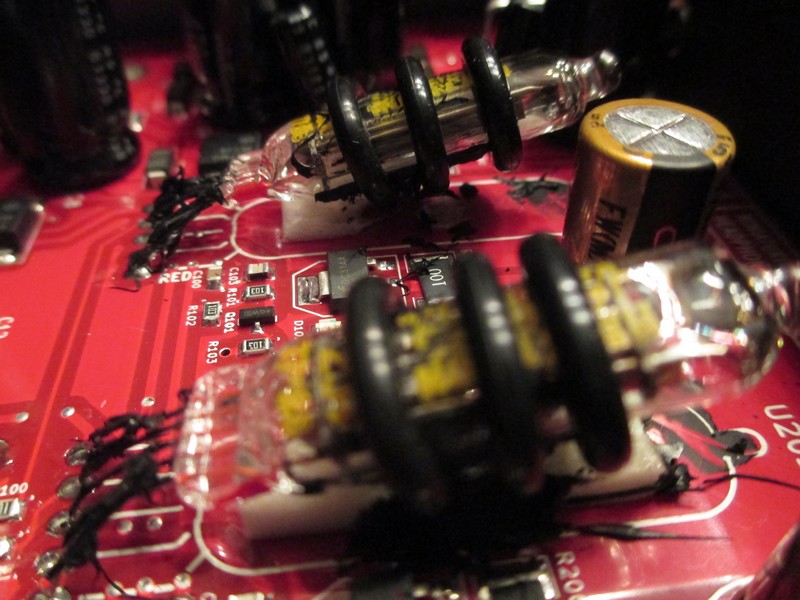

If you're up for a DIY solution, there are some dampening tricks I have seen with these sub-mini tubes.  I can't say for certain though how effective it would be for you.  These tubes are pretty commonly known for oscillation and noise problems in a lot of different circuits.
Heres a mod that adds dampening material and I think it looks like the tubes are socketed for rolling... after a bit of soldering too.
Heres some pics showing some chassis dampening tricks.  These would be easy solutions.
Not the Vali, but heres another subminiature tube amp.  This one with rubber grommets to try and damp the vibration.
