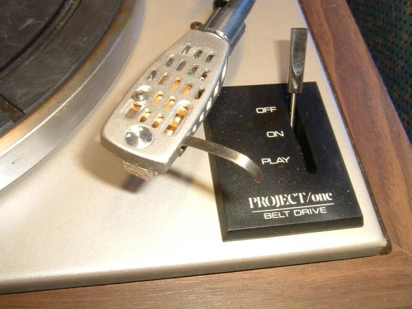

I found this at the house and it seemes to be of pretty good quality. All metal outside parts and has a built in isolation feature. Any one know anything about it?

Afaik, that's the second Project (now: Pro-Ject) turntable model, a modified Teslar design. Should be reasonably good quality.
Greetings from Hannover!
Manfred / lini
P.S.: The second screw & nut for the cartridge seems to be missing on yours...

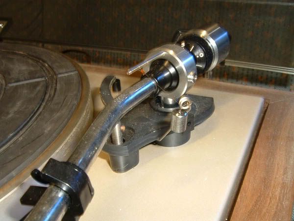

I very much doubt it has anything to do with Pro-Ject but it looks like a copy of a Dual CS505 from the 70's.
If it's a good copy it should sound ok.
The SME style anti-skating weight ( bit of fishing line with weight hanging off ) looks like it's in the wrong place though. I would have thought it should be inside the arm in order to work. It's probably easy enough to rotate it around though.
You should replace the Cartridge / stylus and probably the belt, clean the belt path and maybe change the bearing oil.
This site http://www.soundfountain.com/amb/ttadjust.html has lots of good info on this kind of basic servicing which you can do yourself.

the way the cartridge attaches it by a single screw on the back that loosens the wold assembly. from what i can determine.

I don't mean the big screw for the whole headshell, I mean the second screw for the cartridge itself that's missing - i.e. on top of the headshell you see two gooves for the screws/nuts, but I can only see the nut and screw in the left groove.

It probably just needs the bearing oil changed and a new drive belt. This is something you can do yourself or get a friend who has a turntable to help with.
It may look old fashioned but you will probably have to spend quite a bit today to get anything better. A Rega P3 would be the next step up from something like this. I doubt the Music Hall or Pro-Ject Debut would be that much better.
