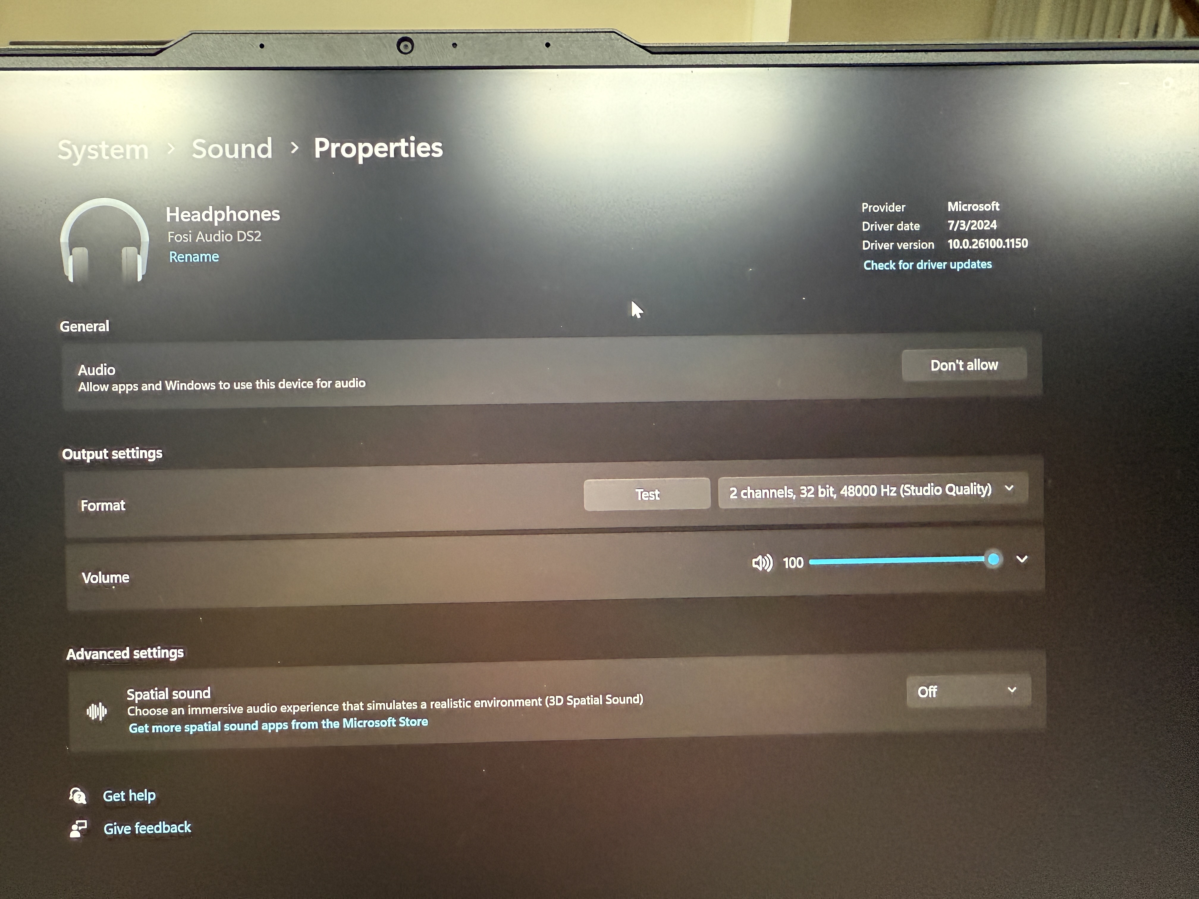

Also, i dont know if this is contributing to what i am hearing, but i notice the DS2 and the Schiit stack are using different channels? The DS2 says 2 channel headphones 32 bit, 48000 Hz (Studio Quality) in the output part of windows 11 and the stack says 32 bit, 48000 Hz (Studio Quality) speakers. I tried to change the DS2 to speakers but can't figure out how.
Would this have anything to do with my sound difference?

Having your output settings arranged for 32 bits doesn't mean your device is receiving or decoding 32 bits. It depends on your device, the music files, and the capabilities of your player. But mainly your music files are the limiting factor. In general you won't see anything in the real world of PCM above 24 bit 192khz; and frankly you can't hear past 20khz (which is covered by a 44khz sampling rate). There are probably test files above that but good luck on finding your favorite artists in esoteric sampling schemata.

The sound difference is not due to the Windows label ("headphones" vs. "speakers"); it's due to how the DACs and amps are tuned. The Schiit stack offers more detail and tighter imaging, while the DS2 has a more relaxed, fun sound with less clarity. For a portable DAC that sounds more like your Schiit stack, consider the Topping G5, xDuoo XD05, or E1DA 9038D.
