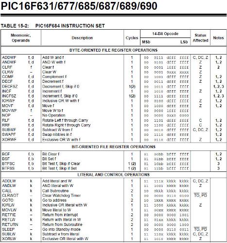

What does a microcontroller or microprocessor do?
A microcontroller is obviously intended to do something. But what?
When first switched on, a microcontroller outputs a specified address on its address bus and reads (fetches) the contents of the memory at that address. (This can be external to the device or entirely internal, depending on the exact design). The specific memory location is hardware programmed into the processor's gate logic. It could be externally set, the address could be read from an external port, hardwired by the user or designer, but it's generally built-in and it's most often address 0, which is the case in the 16F690. The processor treats the number it finds in the first memory location as an instruction, or opcode.
This instruction tells the processor what to do next. This may be any one of a number of things, according to a predetermined list of behaviours specified by number, for example the instruction may tell the processor to read the next memory location in sequence and move the number it contains into an internal register.
In order to sequence its operations, the processor maintains a counter which points to the memory location currently being read. This counter, which is again a number recorded in a register (usually 16-bit), is called the Program Counter. So typically, on switch on, the processors activity is initiated by loading the program counter with 0. The processor reads the contents of address 0, decodes the instruction stored there, increments the program counter and moves on to read the contents of address 1.
The processor must always move on to read another memory address, otherwise the process would stall. Frequently the next address contains a literal or pointer to a variable which the opcode specifies must be treated in a particular fashion. This object of the opcode's attention is called an operand.
The simplest instruction is: do nothing. Otherwise called a no-op.
Do nothing, that is, other than fetch the contents of the next memory location in sequence, and then do what that tells you to do. Such instructions are useful to maintain synchronization in timing-critical operations, by causing a delay.
These number-coded instructions (opcodes) are also collectively known as machine code. Each opcode number is loaded into a special register in the processor called the Instruction Register, causing a unique, numerically coded, chain of events to take place. This chain of events is structured into the hardware configuration in much the same way that an adder is structured to accept 2 numbers at its input ports and output their sum on their output port. This is otherwise called decoding, and the design of such hard-coded logic is beyond the scope of this tutorial. Anyone interested in learning more about this subject should study VHDL (Very-high-speed Hardware Description Language).
For the sake of completeness I have reprinted the block diagram of the 16F690 here:-
It is possible to program a computer by looking up the opcodes in a table and loading a memory bank with a series of numbers which represent instructions. You could do this by setting up the numbers on a data bus using switches, setting up the memory addresses on an address bus using switches and toggling a line connected to the WE (write enable) input manually, using a switch. This is often done in teaching programs, although not all memory responds well to being treated in such a halting fashion.
