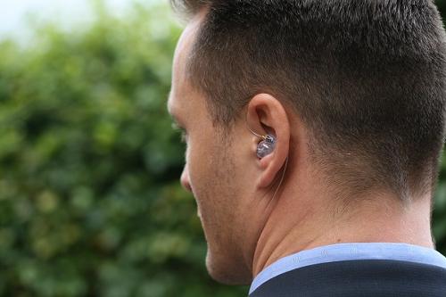

To those who have never seen what a T2 connector looks like, here you go:
