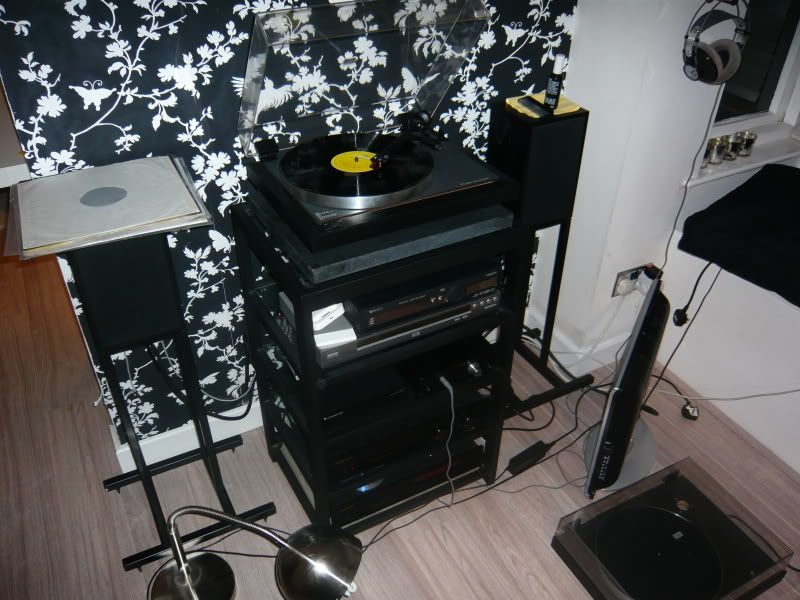

The deck is well isolated from the amps. It sits on a granite plinth 3 floors up from the amp.
