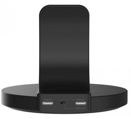

Perfect even for the Fiio M11, I just found on Aliexpress a dock station with an USB-C port dedicated for charging and a USB-C Port for data input or output... I ordered one, and hope the output USB-C will transfer data to my brand-new external DAC SMSL M500 with an ESS pro chip and THX 887 amp !!!
I am really hoping it will solve my issue and no need top pay a crazy price for a Dx220 max or a Hiby R8 ... 25$ is perfect
In my home, I will be free to move or enjoy music connected with a good DAC+Amp, I will have access 2 microSD cards of the M11 with 2 Tb of DSD/Flac files and my NAS/Qobuz as a Dlna renderer with USB player pro or Neutron player (both with very good PEQ).

I got it ... and no luck .. when we use DAC out (Data Out) function, the power is cut from the M11 and start powering the external device even if it's not necessary ...
I give up definitely tu use a DAP as main device for travelling or at home to be connected to external DAC and AMP via USB-C !!!
