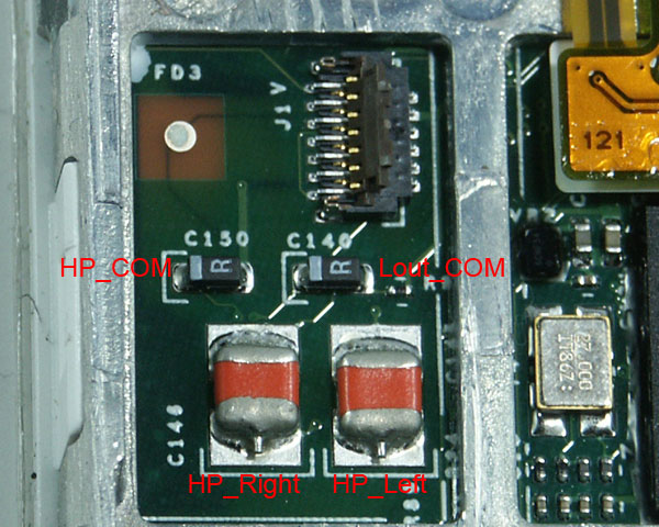

I will call it IPod 5th Gen Headphone capless output  MOD ,  iPHD
With this mod you will have the best audio quality ( if not, the simplest audio path ) that can be achieve with the Wolfson audio codec. The capless headphone output is achieved by using modifed rockbox firmware to enable WM8758's capless output configuration.

In your pic below, it appears the two pads are bridged near the DAC where the two Z caps are removed, correct?

There is no such thing as by pass internal amp. You can read the wm8758b datasheet, audio path, there is no way to do it, and from my point of view, it should not be done, all DAC output have to be buffered for line_out or Headphone.
The iMod has created the misconception,  what iMod do is to by pass the internal low quality zCap, replaced by a better cap in the LOD cable.
The cap is secured to the board by hot melting glue,
The HP_COM connection at the Zcap for this mod is bridged, both pin are at the same DC level, acting as mid point reference driver, which made the sound extremely well controlled.
The HP jack mounting is easy to me, just two screws.

In that pic for your iPhD MOD, there seem to be no pads on the board (can't see any even with a magnifier) for soldering the two wires for AVDD2 & AGND. How did you solder those and can you blow up that detail? Thanks
In the pic below, it seems the HP_COM and HP_left were bridged with a trace of solder. Maybe it just looked like that in the pic.

I just put a few dots on the possible soldering points, The green dots are for AGND,  pink for AVDD. With a very fine tip soldering iron, soldering pads of existing components can be utilized. , otherwise just scrape off the soldering mask to expose the copper if needed.
