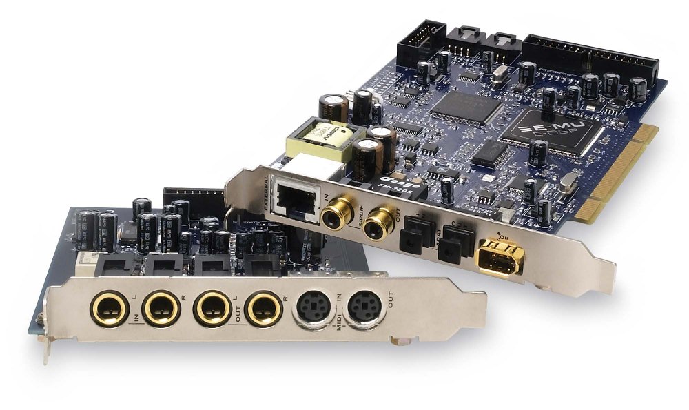

There are two versions of the 1212M. The old version is called 1212M, the newer is called 1212M PCI. The difference is minimal however, the newer version lacks the FireWire interface but is slightly cheaper. See below.
Old:
New:

The 1212M consists of two cards, one analog and one digital. I do not believe the analog card changed between the revisions. The DACs, ADCs opamps etc. are all the same.
Originally Posted by hoki
p.s.: i noticed that in germany this soundcard is always sold as 1212m....since when the second version is the latest to buy?
That's a common mistake from the suppliers. If my memory serves me correct, the new version was introduced sometime at the end of 2006. If you buy a 1212M today, it will be the new version.

E-MU has stated that there is no quality difference between the v1 and v2 versions of the 1212M. The revision (v2) came about due to the need to make the card RoHS compliant, and in the process they also revised some of the circuit board design, which makes the v2 look a little bare in comparison.
Musician's Friend's $99 clearance sale of the 1212M about a year ago was their way of depleting the last of the v1 stock.
The v2 also substitutes an EDI port for the previous Firewire port. This allows it to be connected with the Microdock and Microdock M for added functionality.
