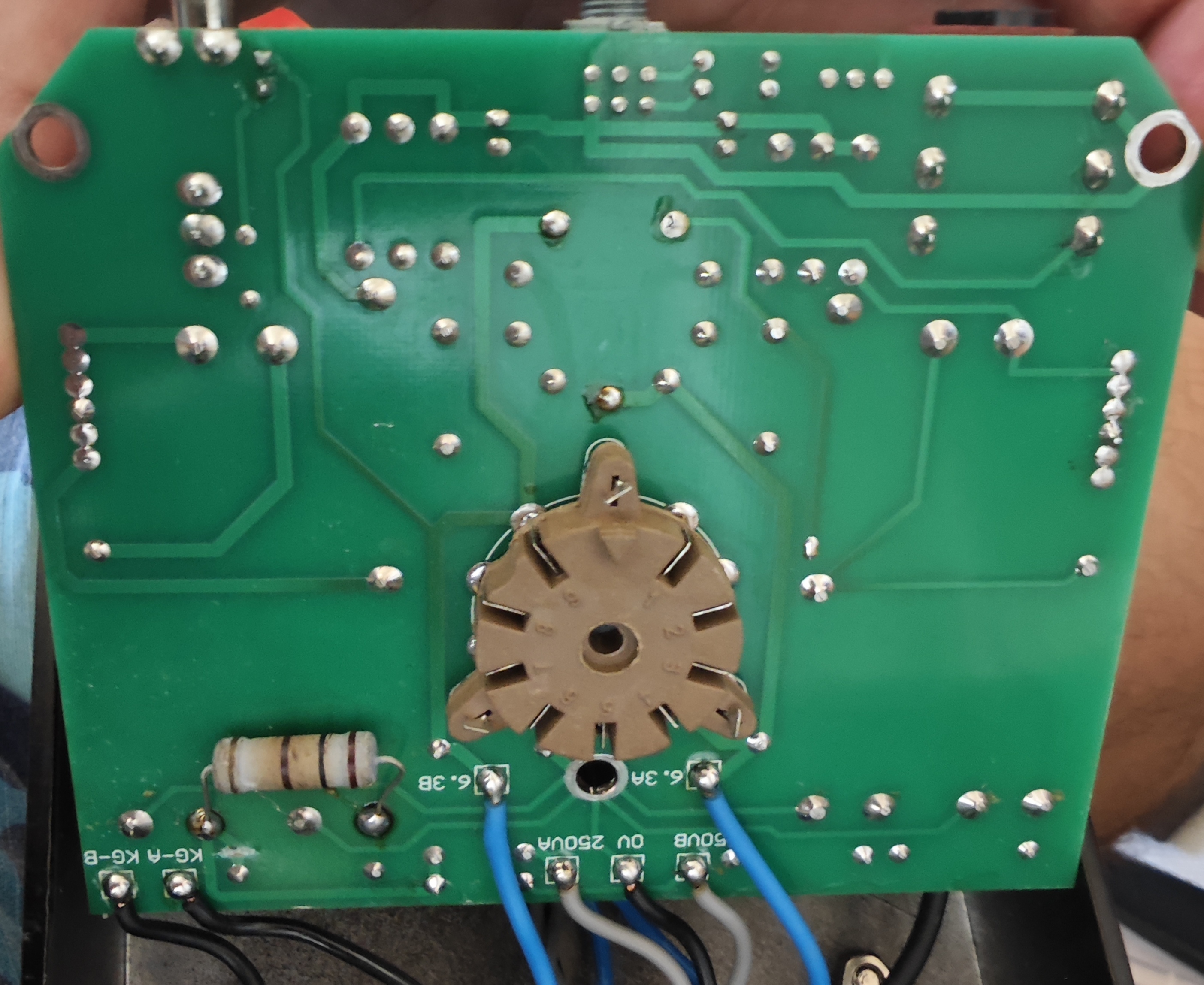

I was curious about the tube rolling possibilities for this amp. When purchasing the amp, you get the choice between JJ Electronic tubes or Electro Harmonix tubes. The Helot uses a 12bh7 and 12au7/Ecc82 tube. The 12bh7 is more related to the transformer and is mainly used to lower the output impedance to run headphones from 32-600ohms. It still does have some an impact on the sound, but the 12au7 tube will have more of an impact on the sound.
If you look at pins 4, 5, and 9 on the PCB picture posted above, they all go up to where it says 6.35. This is the heater that the Helot uses. Since the Helot uses 6.3v heaters, this opens up the possibility of rolling 6sn7 tube variations in place of the 12au7 tube if you wanted to do so.
