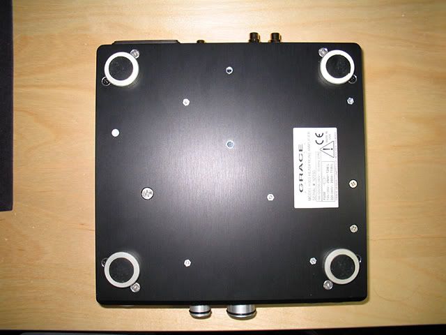

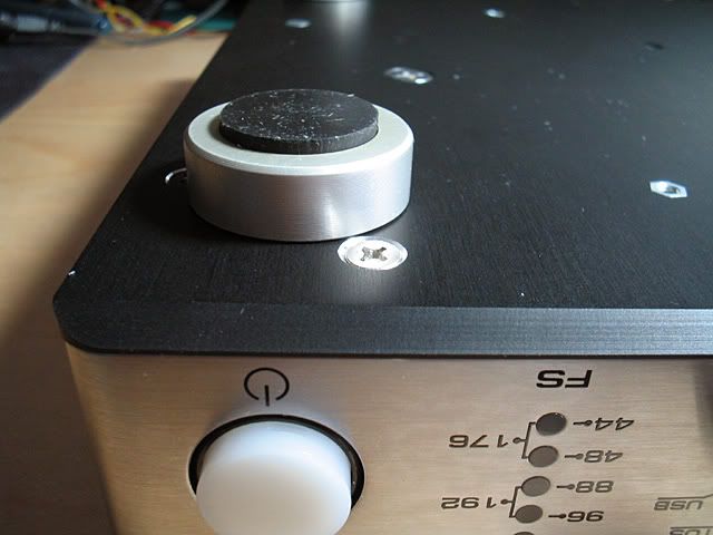

Little foot can be removed by simpy unscrewing. My unit came with the feet not installed. There are little rubber feet included, but if you can, use the bigger feet, they look better and allow more clearance for cooling the bottom of the case.

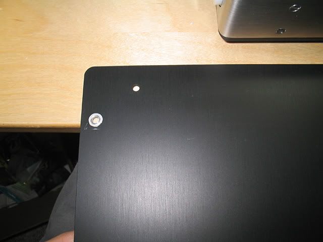

Attention to detail, one area where the screwed in top meets the frame has the anodization stripped off to make conductive contact.

Notice that the Bottom of the case, in fact the whole case acts as a heatsink now. The m902 operates more warmly, but not uncomfortably hot. This is due to the better heat dissipation.

Also, the power button is not recessed like the 901. This means that it is entirely possible to accidentally turn the power on or off. Not something you'd expect to see for a piece of pro audio equipment. But it's a minor issue. Just watch your hands.
A thinner bezel matching the ones on the headphone outputs could solve this "problem", but I like the cleaner look.

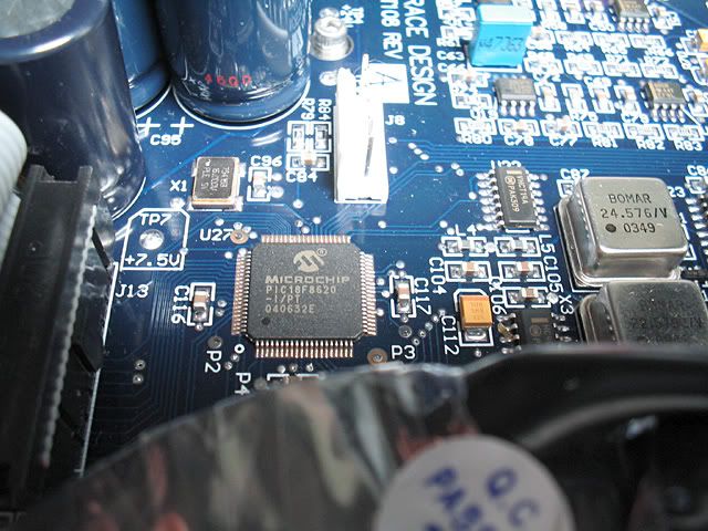

Because the m902 does not use a stepped attenuator like the 901, the microprocessor controlled volume has much finer steps than the 24 (+hi gain, so, sort of like 48 steps) that the 901 has. There is an option to increase the gain to be able to ramp up the volume faster. (This is a must for the K1000's).

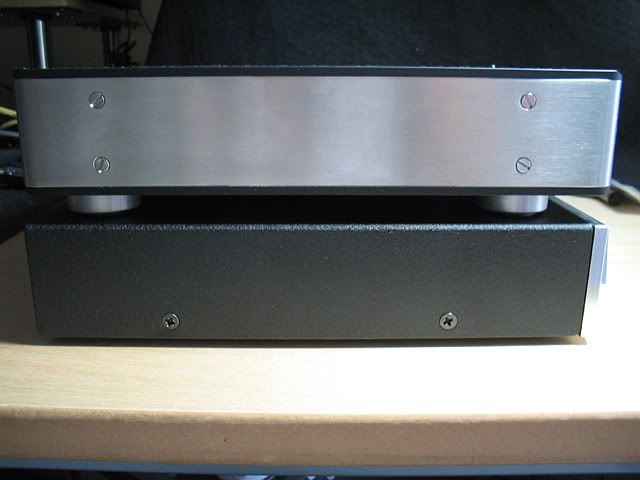

And last but not least, a little m902 and 901 comparison pics.
