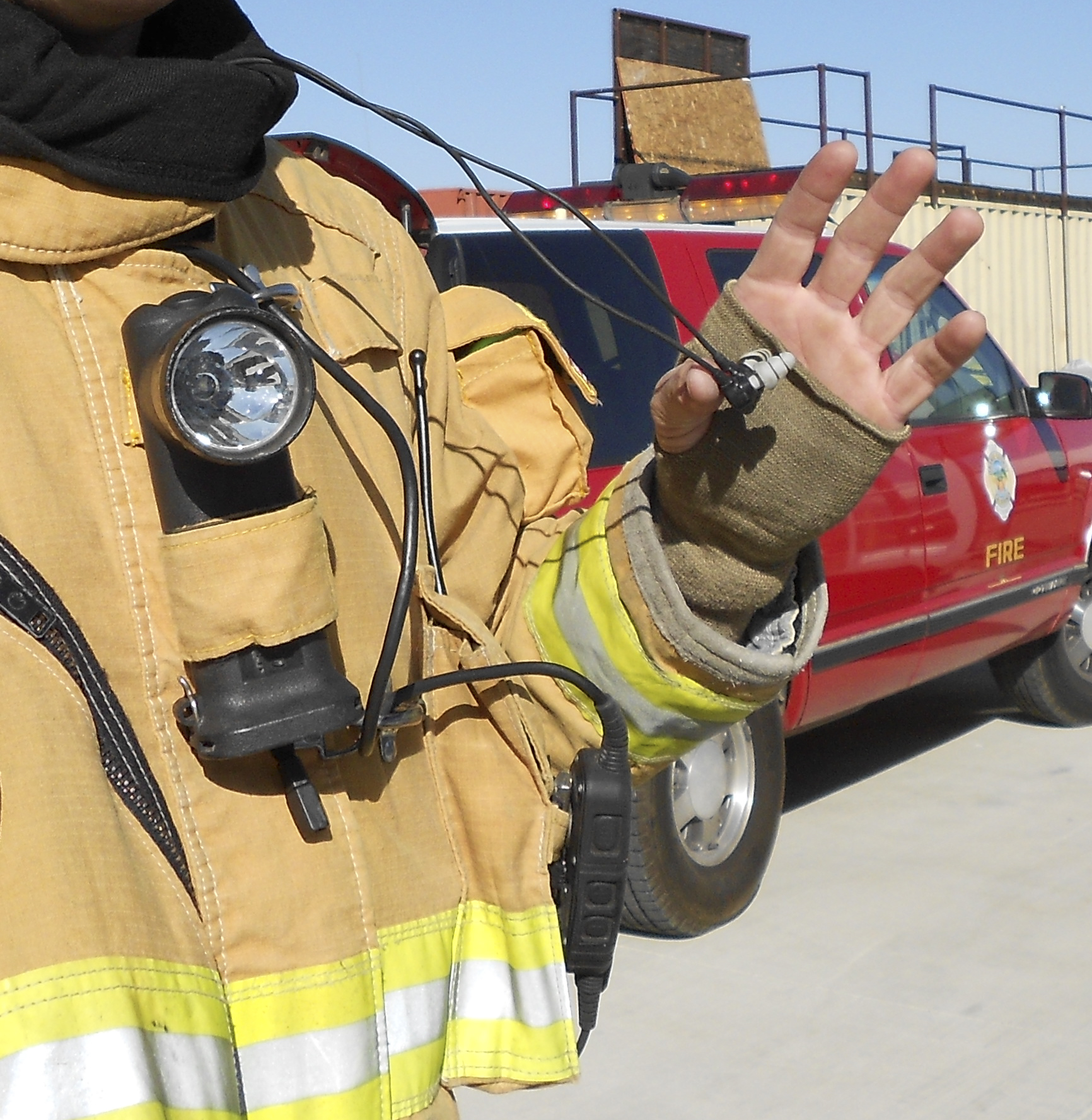

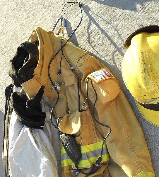

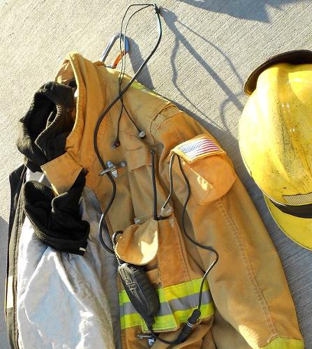

In this image, a Peltor headset with a Push-To-Talk control is clipped on to a bunker jacket. Note how the wires are passed through various loops, etc., to keep things from dangling and tangling.
Here you can see the "earbuds" of the Peltor device. It is my understanding that this tactical headset, which is used by certain military units, filters out impulse noise...the type generated by weapons when they fire. Other sounds, such as might be experienced by firefighters, are not filtered out.
