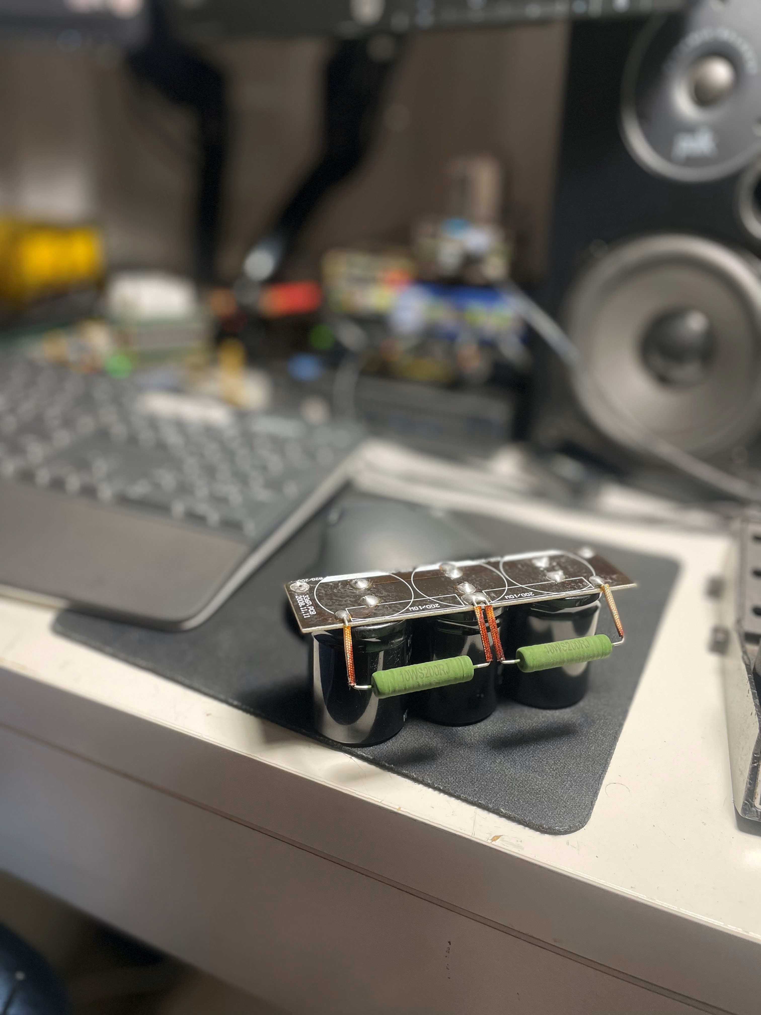

So I see that its an old thread, however I have begin the mods on a DV336se for good.
At the moment I have been changing the capacitor’s that were damage on the procedure of manufacturing and some mods using this thread as a guide.
old Cap's
Since they are bigger I do end modyfing the board.
At the moment change the HV capacitor's for some Marcon 1000µF 250v
Still waiting for the 220µF they use 315v for those ones however I end up getting some 250v since they do not see near 315v in those cap's at all.
Already order an Alps RK27.
Right now I am looking for a way to make everything inside as a plug and play style in order to service it at some point in the near future. So would be keeping you guy's and gals posted.
If any sugestion arraised I would appreciated.
Thanks,
-Gus
old Cap's
Thanks,
-Gus
