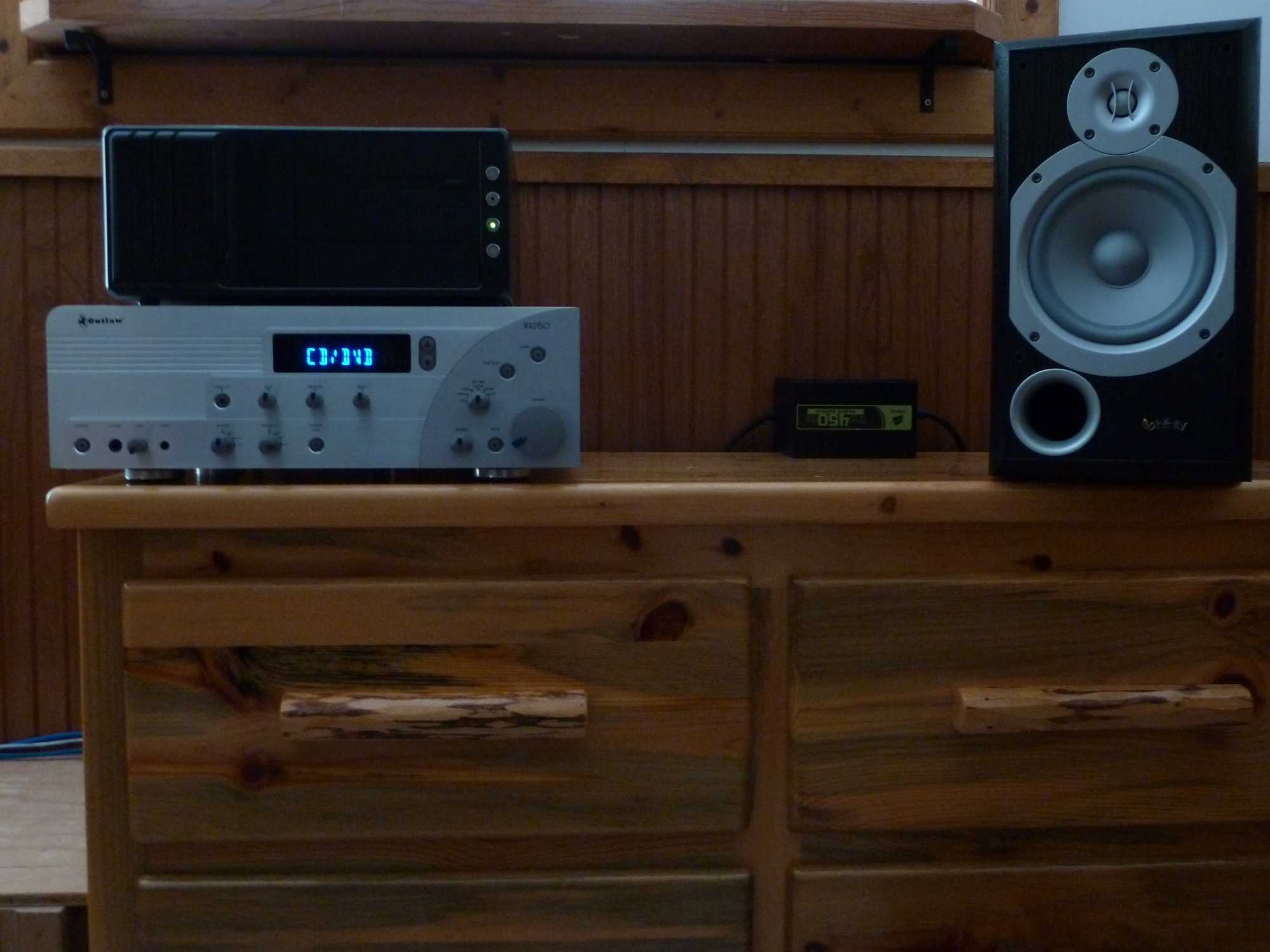

Here is my setup:  the power supply is chillin' on the dresser to the left of the speaker.

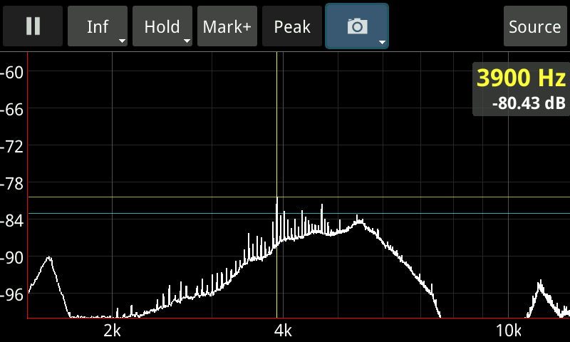

I wanted to get an idea of the actual noise the computer was adding to the system.  Here are some interesting results from FFT using my Samsung Droid Charge with Audia Sound's FFT app.  The results are using FFT resolution of 16K with infinite averaging over a period of about 2 minutes each.  The phone's mic is placed 1cm from the tweeter in each measurement.  The receiver's volume knob was at full maximum or minimum for the measurements.
The conclusions I have come up with:
1.  The CD Input has the lowest noise of all the inputs (With RCAs from computer connected with the computer off-- this result may change if I disconnect the RCAs)
2.  The AUX Input is the worst input, with far more noise than the other inputs-- nasty.
3.  The computer adds some noise to the CD Input, but very little.  Some noise shows up between 10kHz and 20kHz as well.  One can see the difference between the CD Input with the Volume maxed with the computer on and off.
Looking at the noise levels on the CD Input with the computer on and off makes me wonder if it is really even worth the trouble at all to filter the computer's power supply.  Does anybody have an opinion of the noise added?  Remember the computer is providing 2.0Vrms to the receiver.  With any driver on Windows XP or 7, the sound card preout volume is always maxed out.  With the receiver volume at maximum, that would be some serious output.  Most of my listening occurs with barely 1/10 of a turn of the volume knob.
