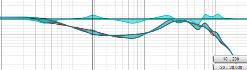

Update. I create FR in equalizer APO measure base on visual
# GraphicEQ: 40 -2.15; 50 -2.5; 60 -3; 70 -3.7; 80.1 -4.1; 90 -4.6; 100 -5; 200 -8; 299.4 -10.2; 400 -11.8; 500 -12.2; 600 -12.6; 647.2 -12.8; 700 -12.6; 800 -12.2; 900 -11.4; 1000 -10; 2000 -1.55; 2300 0; 2534.9 -0.4; 3000 -2.5; 3461.8 -1.6; 3756.4 -1.1; 4000 -1; 5000 -5.4; 6000 -7.9; 6197.91 -6.65833; 6715.3 -2.4; 7000 -1.55; 7286.9 -2.3; 7823.92 -4.31037; 8000 -5; 8671.63 -8.7715; 9000 -10; 9240.49 -9.47588; 9728.22 -7.59751; 10008.8 -7; 11082.5 -12; 12066 -14.8; 15509.1 -20; 19060.2 -32
import it to REW use harman-in-ear-2019v2 as room target
setting
finally got a match
here is the final result I believe can strictly use as one of auto-eq result to imitate other earphone
Filter 1: ON PK Fc 191.5 Hz Gain -2.90 dB Q 2.000
Filter 2: ON PK Fc 698.0 Hz Gain 3.10 dB Q 1.309
Filter 3: ON PK Fc 2510 Hz Gain -5.40 dB Q 1.000
Filter 4: ON PK Fc 2948 Hz Gain 5.90 dB Q 2.078
Filter 5: ON PK Fc 5608 Hz Gain 5.30 dB Q 2.690
Filter 6: ON PK Fc 7101 Hz Gain -4.20 dB Q 3.310
Filter 7: ON PK Fc 10671 Hz Gain -3.40 dB Q 2.889
Filter 8: ON PK Fc 40.00 Hz Gain 2.70 dB Q 2.000
