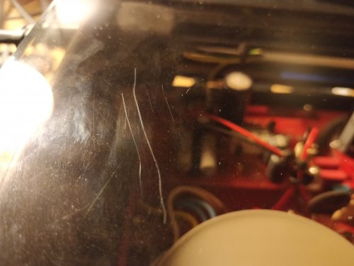

Some scratches on the acrylic top... No biggie though.
The pot definitely reveals the unit's age :wink:
