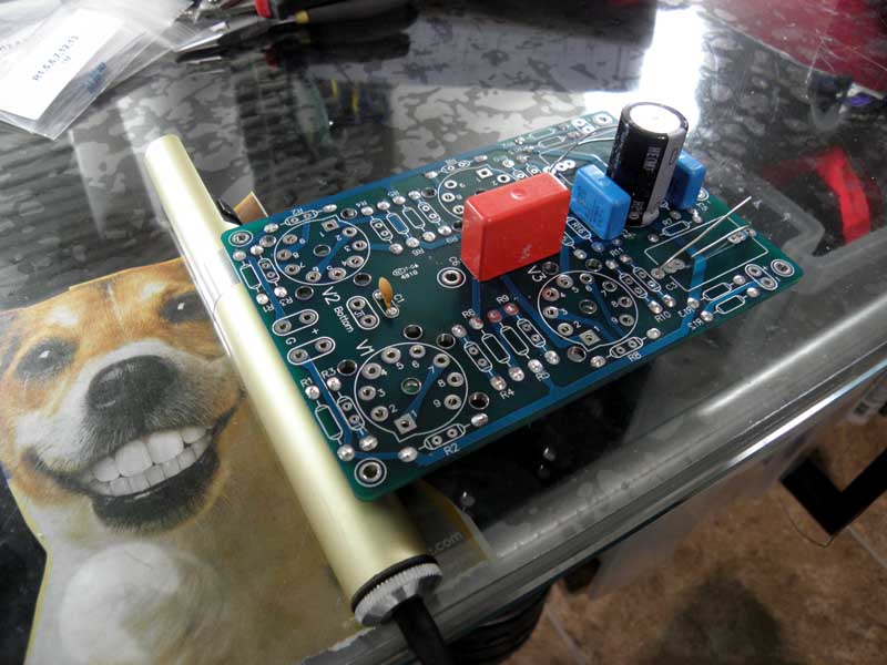

FINALLY got in my LV! Felt like forever but the holidays must have slowed shipping down. Initial thoughts on the kit....
- Packaging was excellent, no complaints. Everything was clearly labeled and came with the manual printed!

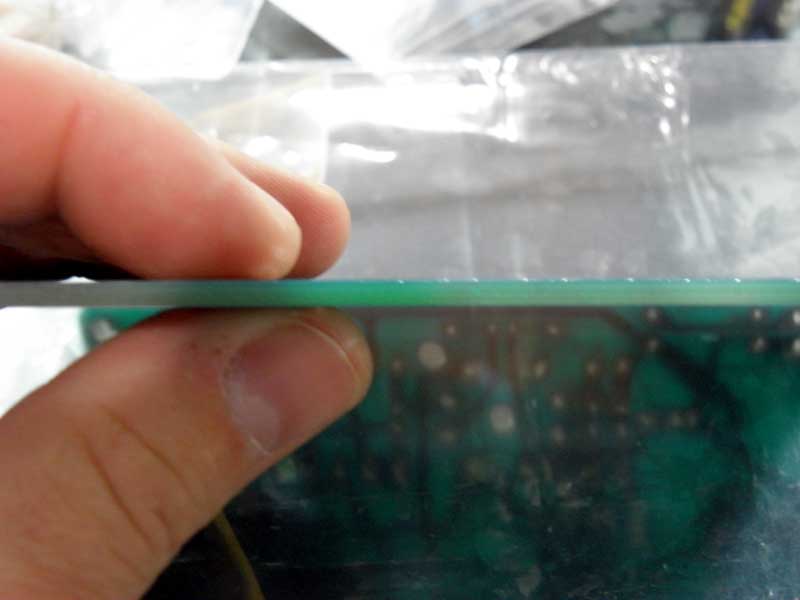

- Circuit board... Good lord thing thing is 3x thicker than I thought it would be for such a small board. One thing is for sure, you could press and pull on tubes all day long and this baby is not gonna break or flex!
Will get around to solder slinging in the next few days and have to dream up the enclosure, then order tubes. Still have not made up my mind but will probably start with 4 JJ ecc99 gold pins at 48V and then reference everything off those for my tastes.
Some pics of the kit and the crazy thick board....
Jan 4, 2011 at 12:42 AM Post #4 of 20
So I got anxious tonight and jumped on the project :) Soldered the whole unit up / reverse flowing the solder to make sure it is uniform throughout the via. Turned out decent I think! I have not soldered in either coupling cap yet as position will depend on the chassis. I also have not soldered in the 9 pin minis yet as I may change them out to a little fancier gold plated units. Yes I know, I know I will not hear any difference but the ones I am looking at have the center of the socket open so I can shine an led through them if I wish. Riced out tubes FTW! Also to note, I soldered all of the other caps on the bottom so I can mount the circuit board higher up in the chassis to show off the tubes more :)
Last note for those with a keen eye, Yes R17 is missing... someone forgot to put it in the package *LOL* Not worried about it, can snag that locally.
