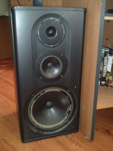

Hi everyone, I'm totally new to this forum so I hope I'm doing things right. Anyways, I found a pair of Jamo CL 25, a Sony GX47ES receiver and a Sony CDP-C245 in a flee market for 50 bucks. I decided to plug it all up, and it sounded great, except for the bass. There's none actually. I thought it was because the foam ring around the lower speakers are completely ruined (these towers must be fifteen years old) but I asked on another board anyways, and they said that while it might not help, the amp in the receiver also might not be powerful enough to drive the Jamos.

Pictures if it may help:

You don't need a new amp. You need to replace those woofers in the speakers or find someplace that can re-cone them.

Well I did try to plug them on another amp (Denon DRA-545R) and it already sounded much better, so I really think a new amp would do a difference. Also, I found this: http://www.audio-parts.de/product_info.php?language=en&gm_boosted_product=Jamo-CL-25-Lautsprecher-Sicken-reparatur&Lautsprecher-Sicken-Reparatur=Jamo-Lautsprecher-Sicken-reparatur-set&Jamo-CL-25-Lautsprecher-Sicken-reparatur_html=&products_id=368& to refoam them. Does it look any good?

Well if the Denon worked better, then there's probably something wrong with the Sony you've got.
As for the kit, if you think you're up to doing it yourself, go for it. It's certainly quite inexpensive.

You really need to refoam those woofers then try the Sony again....really. The hardest part is getting the old foam off, the rest is pretty easy if you're careful to center the cone. I've even seen people use duct tape to "refoam" the cone- it worked. You're not going to magically get bass with a different amp unless the Sony is defective.
