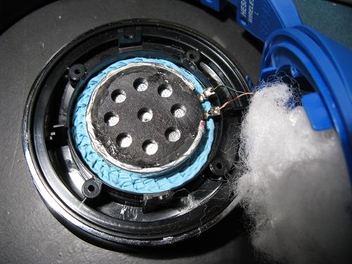

Finished a Level-3 mod.
560uf OS-CON output caps, Beyer DT770/32 ohm drivers. 1 gram Acousta-stuf in the cup to deal with echo.
Lets call it a Level-3-770
Some impressions, Level-3-770 (comparing to Level-1-KSC55)
* doesn't play as loud. Sound level is maybe 3 clicks lower. Still plenty loud enough.
* much cleaner sound with much better detail/clarity than Level-1 (in comparison, Level-1-KSC55 sounds congested with a thick cloud of haze in the background).
* less bass quantity and impact than level-1-ksc55, the bass is slightly lighter than my liking (am a bass-head after all
). much better bass texture though.
* smooth mids and highs, no bites, no sibilance. Mids more recessed than the level-1-KSC55.
* presentation is much more layback than the Level-1-KSC55.
** for rock listening in high volume, the Leve-1-KSC55 is actually more engaging, the sound is "dirtier" but it "rocks" better.  In comparison, a Level-3-770 is more like a high resolution back ground listening setup,  very enjoyable even at mid / low volume (there is no need to turn it up, all the details are already there).
** Level-2-KSC55 lays somewhere in between, it has the layer of haze in the background but not very noticeable unless compared directly to the Level-3-770;
The comparison above is done with Bluetooth connection.
When connected using a cable to an iBasso DX90, the Level-3-770 really scales, sounds much better than running bluetooth. The Level-1-KSC55, on the other hand, doesn't improve much. ==> I think the limitation of this bluetooth board has been reached, Beyer 770 drivers are over-kill for it.

Level-3-PX   (with Senn PX-100ii drivers)
* output caps changed to 560uf/6.3v OS-CON
* Sennheiser PX-100ii drivers (32ohm)
This mod requires a lot of stuffing material. With 1 gram of Acousta-stuf, the sound was boom, boom, boom, boomy. Change to 2g, still boomy. Change to 3 grams per cup (at this point the cups are firmly packed with stuffing), the bass is still very strong, border-line boomy (overpowering at times). I don't think it is realistic to pack more stuffing into the cups so I called it good enough. Sound is very warm, soft and layback, certainly not fatiguing. But the extra bass muddles the sound a bit.
These drivers came from DavidA,  with sorbathane pads. Add sorbathane pads on top of driver magnet, the sound cleaned up a bit, the best stuffing amount seems to be around 2.5 grams of Acousta-stuf per cup (bass got too flat with 3 grams of stuffing). The problem at this point is the bass, it is strong and fat but kind of "flat" (instead of the more natural "fat and round"), I don't know if it is the fabled "bass fart". I ended up removing sorbathane pads and went back to bare driver with 3g stuffing.
Sound has good enough detail, and is cleaner than the L-2-KSC55, but the sound level is much lower than both the L-3-770 and L-2-KSC55, and there is noticeable distortion at the max volume setting. I suspect the headphone amp section doesn't quite have enough juice to properly handle these PX drivers.
Good for low volume back ground music listening (can still feel the bass at low volume).
