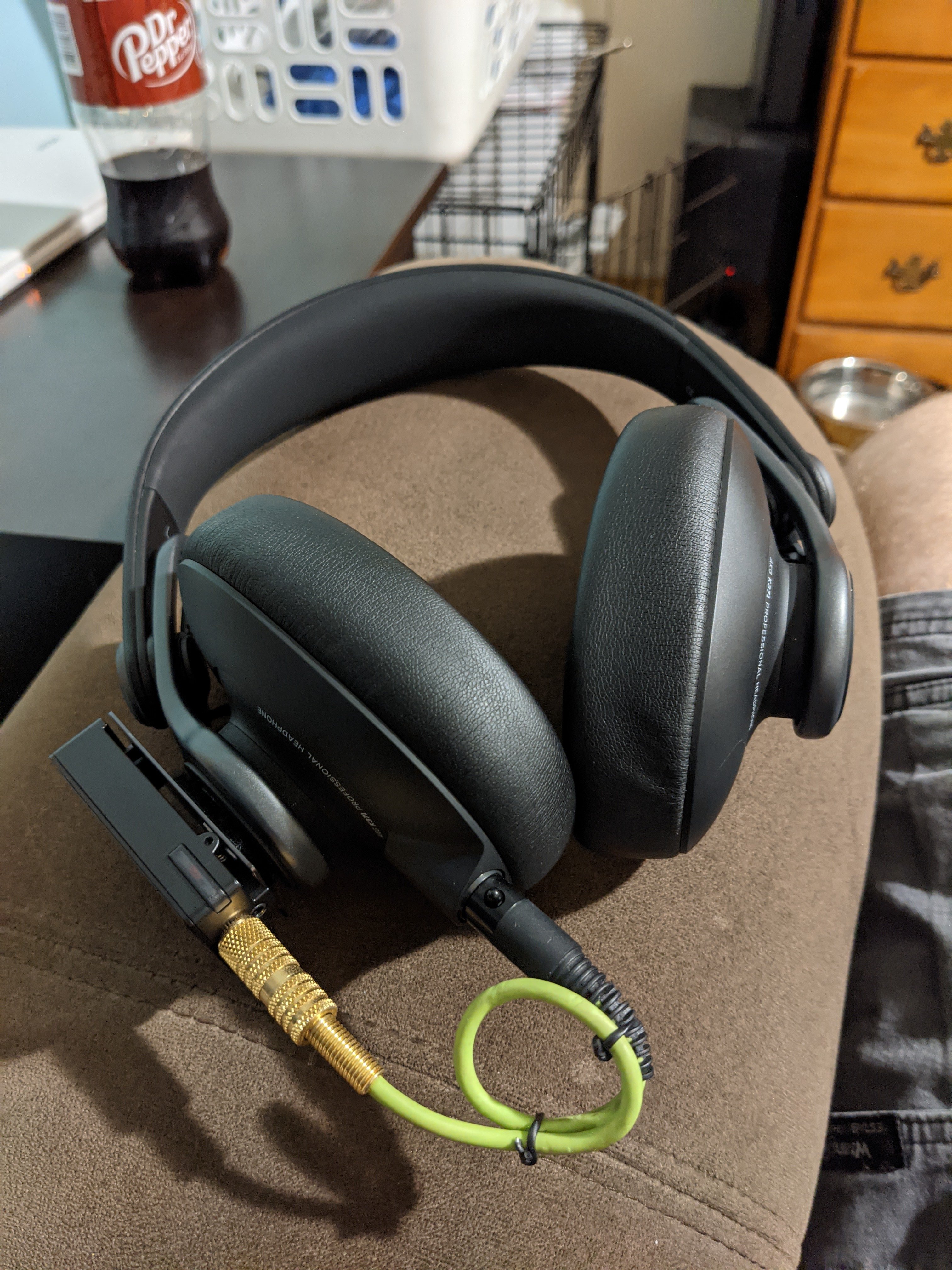

Looking for suggestions on the right soldering iron for making a headphone cable. Basically what I want to do is chop up an oem AKG 3.5mm to mini XLR cable and make it shorter, much much shorter. It's going to be for a K371 to a Qudelix 5K which will be attached to the K371.
So the plan is the cut a large section out of the cable, and solder the cable back together, only much shorter and then cover the connection with heat shrink tubing to seal it and strengthen it.
So what would be the type of soldering iron and solder I need for these very small gauge headphone wires?
For picture reference I want to do what's in this picture but hopefully a bit cleaner.

Sep 19, 2020 at 12:11 PM Post #8 of 9
Yeah that would be nice, not sure if any exist either, they have them for full size not sure if for "mini" or Neutrik calls them "tiny" XLR.
Easy to find for 3.5mm though.
Another trick is to not use the boot on the mini xlr. Use 3:1 adhesive lined heat shrink and maybe first encapsulate the connections with a resin like epoxy.
When you apply the adhesive type heat shrink and it is still hot you can bend it and it will hold its shape after it cools. Doing this you can fake a right angle connection.
This gives you a makeshift strain relief. A 3:1 adhesive lined heat shrink is going to be quite strong- its not floppy like standard 2:1 heat shrink.
Sep 19, 2020 at 12:13 PM Post #9 of 9
