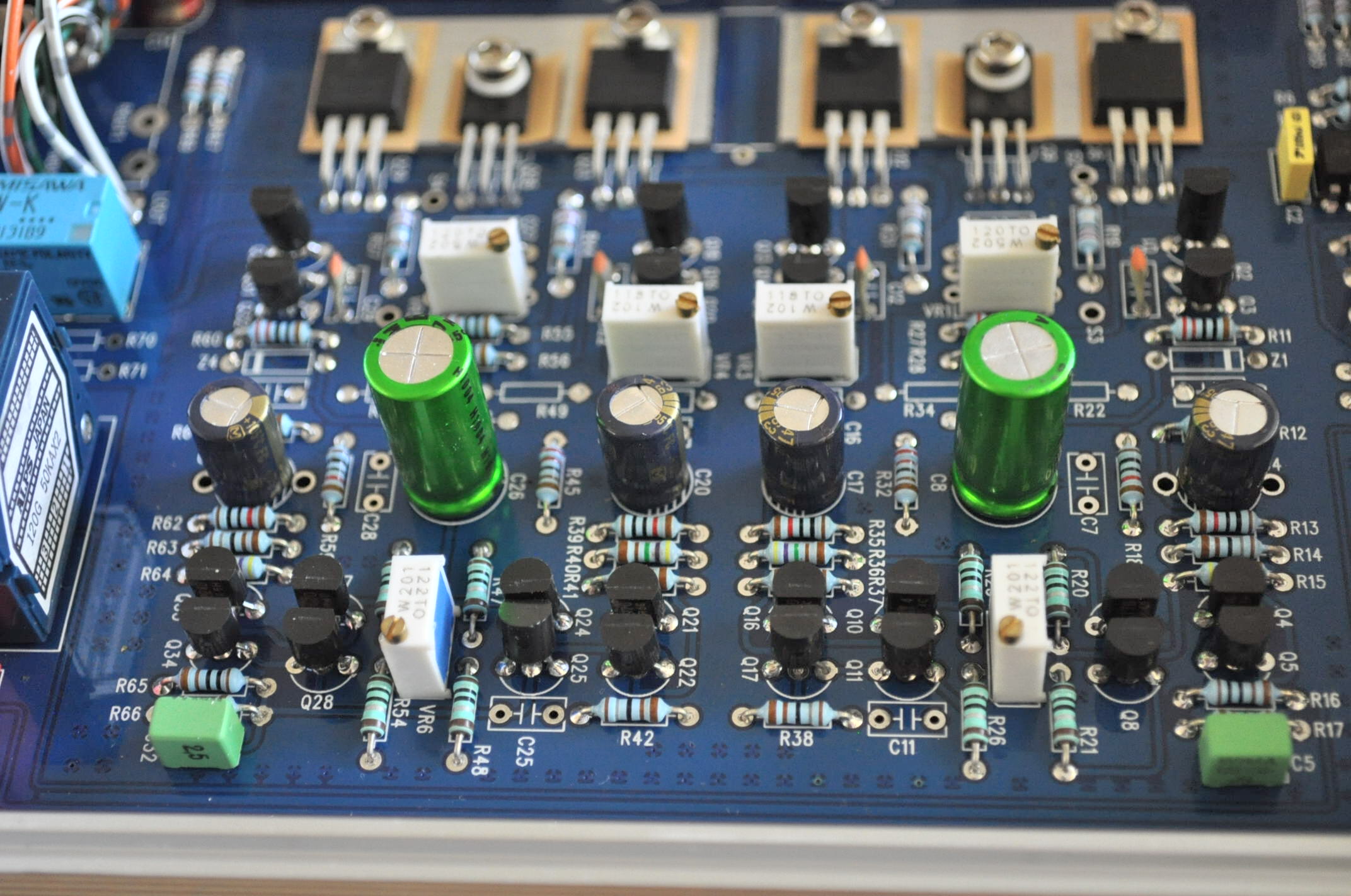

Internally, there's a lot going on inside of this amp. Power supply features a Plitron toroidal transformer, large Elna smoothing capacitors, and a pair of LM337K linear regulators. Worth noting is that Yulong chose to use the TO-3 metal can package which allows for higher current than the standard TO-220 package. Each one is embedded in a rather substantial heatsink for maximum thermal efficiency in this high-current application.
As mentioned prior this is a totally discrete design. In the eyes of many, discrete designs will always be superior to opamps. Period. I’m not necessarily in agreement with that as a blanket statement - I’ve heard good and bad examples of both types, and each design has unique advantages and weaknesses. The trick is to design the circuit in such a way that those weaknesses are no longer a factor. Many of the prior Yulong designs use a combination of opamps and discrete output stages, so Yulong has experience with both.
There actually is a single opamp in the A18: an OPA2604 used to buffer the RCA input. This is similar to the Yulong A100 amp, and said to reduce dependence on signal source as well as interconnect cables. Aside from that everything is done fully discrete - K170/J74 JFET input stage, and MJE15030/31 low impedance output stage. Quality parts are used throughout the entire assembly, including Vishay BC series resistors and select Nichicon Muse capacitors. All connectors are from Neutrik and the volume pot is the popular RK27 "Blue Velvet" from Alps.

Jun 24, 2012 at 8:24 PM Post #10 of 177
unless there is more to this amplifiers than the pictures show, i don't see how
this can be a balanced amplifier with only 2 sets of output transistors and
a 2 channel pot.
edit: full chassis pictures on ebay confirm that this is not what most of us
consider as a balanced amplifier. There is no bridge output, nor are there
4 seperate amplifiers.
This is a dual differential cascoded jfet front end, single vas stage
and class A or class AB output.
For the price it is still a good deal.

Thanks Kevin. I've clarified in my original post, though I need to go in and do a full edit to make sure it is very clear. Yulong was never trying to deceive anyone about this fact - nor was I for that matter, but it's still my fault for screwing up.
