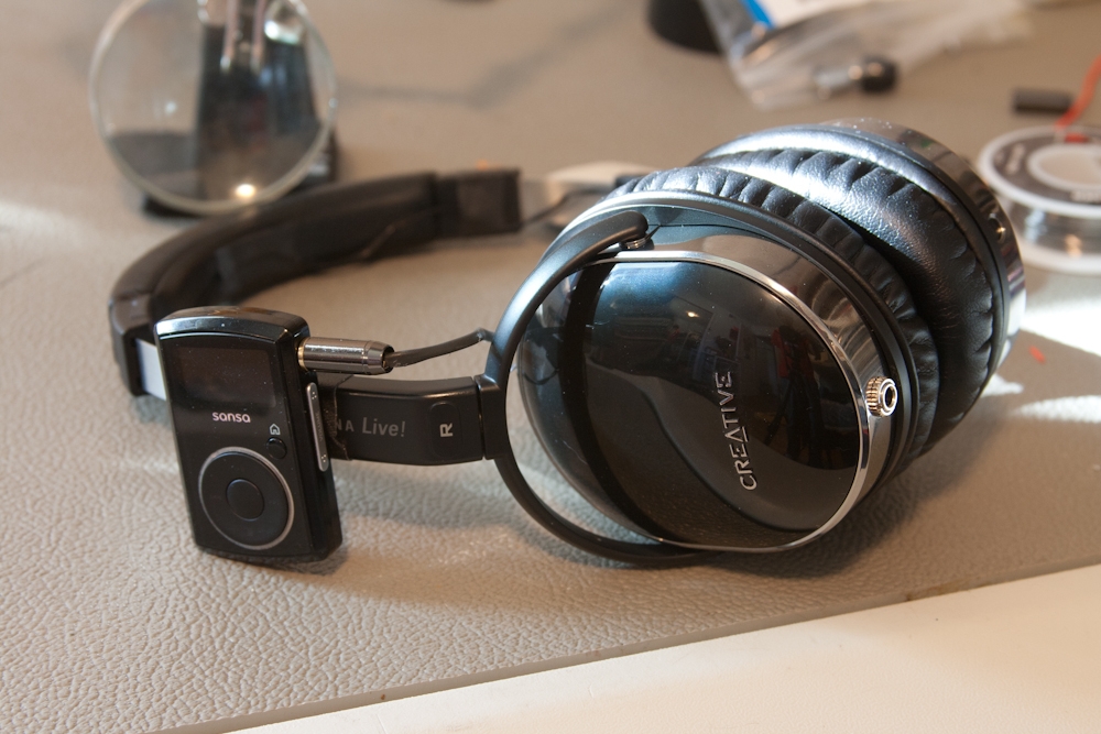

Pictures first:
Picture 1: I have moved the Sansa Clip to the inner headband and moved it down a little bit but it otherwise looks similar like this:
Picture 2: Creative Aurvana Live headphones with the removable single entry able and without the Sansa Clip:
Picture 3: the modified CAL with Clip on my head (Note they work without noticeable cables!):
      As you can see, these are basically CALs (Creative Aurvana Live) modified to contain a Sansa Clip inside the headband. They can alternate in either “wireless” or “wired” mode:
1) “Wireless”, powered by the integrated Sansa Clip; or
2) Wired, simply insert the removable single entry cable and the wireless mode will be immediately terminated. So I can use them with an iPhone in the pocket of my pants.

           Brian “Pingupenguins”/ at BG Audio took my rough idea and created this gem. He did the following:
1) Enable switchable inputs to the CAL (one input from the integrated Sansa Clip and the other from the removable single entry cable)
2) Converted the dual entry cable to single entry by routing one cable through the headband.
3) MarkL mod the CAL to tighten the bass.
4) Velcro the Sansa Clip to the headband (the Sansa can still be removed easily).
5) Rockboxed the Sansa Clip.

Thanks for your comment, JK1. I actually have the CAL that way (Clip attached vertically to the inner headband of CAL, please see the photo on my head).
With V80 and Clip in the vertical orientation, however,  fit and comfort is not as good as horizontal outside mount. On my head, V80's headband does not have that much of space for a comfortable inner mount.  YMMV. Edit 2: V80s / M80s have retractable/adjustable headband. If too much inner headband space is used to mount Clip, your headband may not be adjustable any more (thus can not fit into the carry case).
