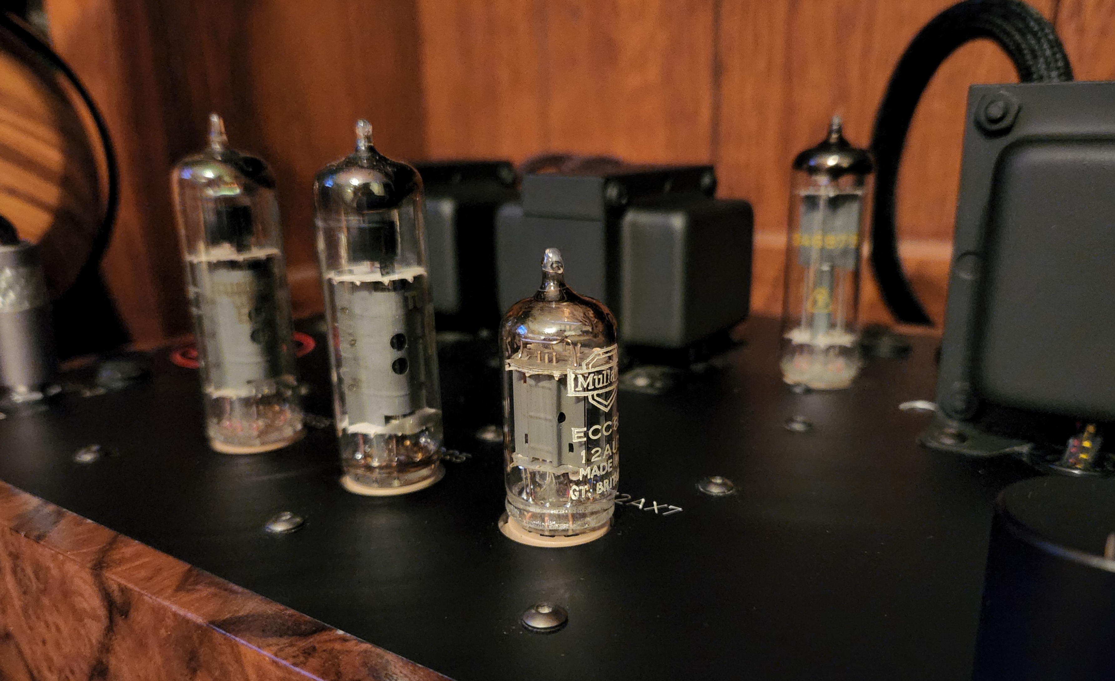

Pulled out another famous ECC82 from my stash last night. This was the first 12AU7/ECC82 that I fell in love with years ago and with what I am hearing now I can totally see why. I don't know why it took me a year of owning this amp to finally roll it in. . .but you know what they say, better late than never. :wink:
Funny thing about this tube, is that before owning the Pendant (yet knowing I would own one someday), I remember reading people's impressions of the amp, and I always thought to myself that I would try this tube first. Well, I finally got around to rolling it in yesterday and sure enough it is everything I always thought it might be and more in the Pendant SE.
Say hello to the one and only, Mullard ECC82 Long Plate Square Getter - Blackburn 57'. :grin:
This tube is the poster child for the "OG" Mullard house sound and has legendary status and price for a reason. There is killer detail, impact/note weight for days and a very holographic stage. Paired up with some Tungsram EL84 Welded Plate Foil O Getters and a RFT EZ81 Welded Plate Foil Disc Getter, it's a very immersive and "lifelike" experience. The bass is powerful, tight and textured and hits with authority. The lifelike timbre, texture and detail of the mids is to die for. Lastly the highs are smooth and fatigue free. The vocals and holographic stage with this tube are insanely good, and other than the bass, they are the major standouts. This tube is a winner no doubt, and another one from my collection I am glad I never sold. Back to musical bliss. . .
Happy Hunting, Rolling and Listening!
