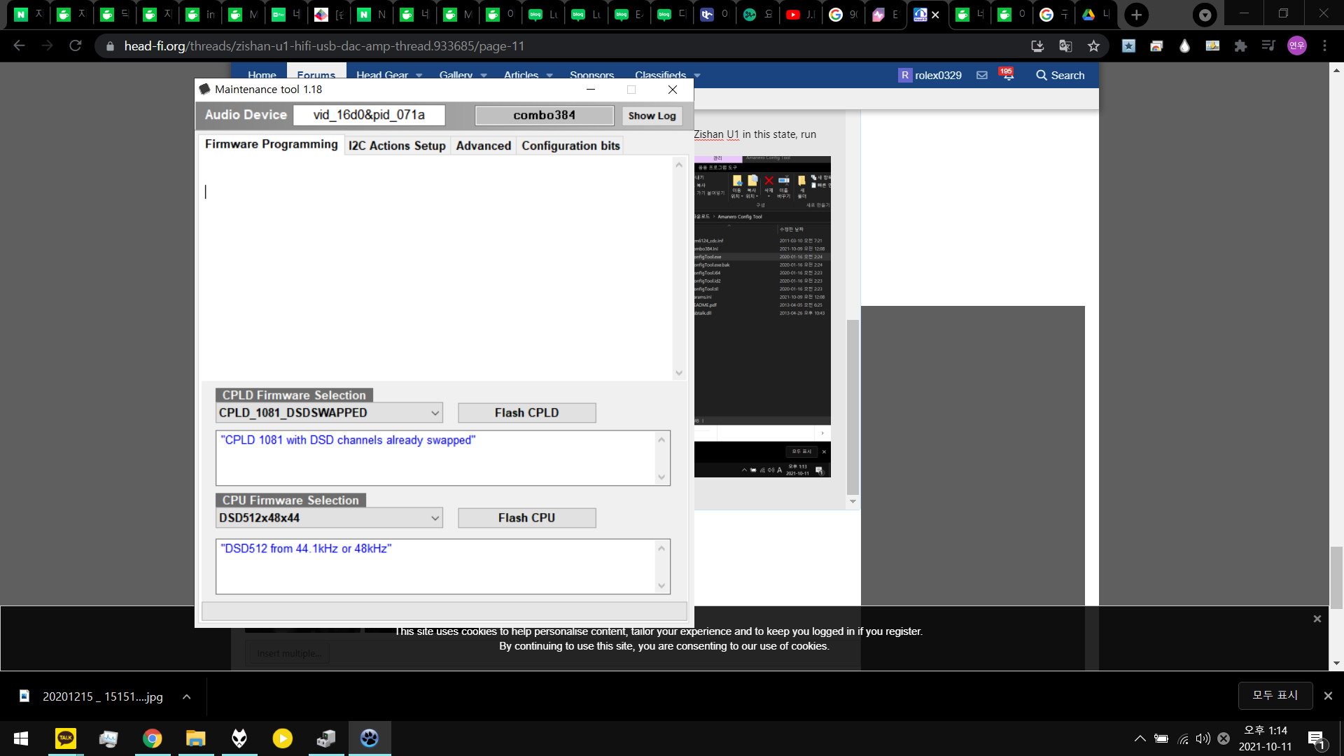

2. U1 is a daughter card compatible with the Italian Amanero digital interface
Zishan's preferred dual crystal + CPLD I2S solution, which leads to I2S key signals for players to DIY. Just want to connect to the computer and do not want to toss the buyer to unplug the battery directly, short J1 can be used as a "desktop" USB decoder, U1 is at this time The USB DAC port takes power. The configuration of this decoder is not simple, but the Amanero digital interface + full blood AK4493EQ + Tu 9V power supply + dual OP275 + native 3.5 LineOut + HIFI standard amp for the tube amp! It is convenient for everyone to pick up the speaker.
The default firmware is compatible with CPLD_for_1080 + DSD512 × 48 × 44
Driver compatible with: see in the links section below (A)
Support up to PCM 384K 32Bit
The DSD hard solution only guarantees DSD128, because the profit is meager, other DSD256 DSD512 settings must be tossed by Baidu or Google, search for the keyword "Italian amanero foobar2000 settings", very much information. Important things said three times: meager profit, no technical support! Low profits, no technical support! Low profits, no technical support! The following DSD setting links are for reference only.
Link: see in the links section below (B)
