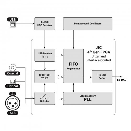

MAS refer to “Mobile As Source”. The term probably sounds new to you, but I guess we all wanted this feature as some point. From technology perspective, there is nothing difficult to implement this feature, but we try this with our own system, we probably feel discouraged because it doesn’t sound good when compare to our computer or regular setup. We always thought digital bit stream is only a matter of 0 and 1, they should always sound exactly the same, but do they?
To use mobile devices such as phone or tablets as music source to high-end DAC, there are two problems we need to solve: compatibility and signal quality.

Mobile devices are highly integrated solution with loads of electronic components that interference one another in a very compact environment, this is not a desire situation from audiophile perspective, so even we can get it work technically, the outcome might not be very pleasing. Some of the high quality DAC is very sensitive to the quality of digital signal upstream and they probably will have a hard time to deal with the high jitter, unclean digital signal from mobile devices.
Fortunately, YULONG is in a better position to work with MAS concept, our JIC (Jitter and Interface control) will clean up the signal and reduce the jitter to a very low level. There has been reviews reported that our JIC equipped DAC “sounds just as good with a standard Surface Pro or off-the-shelf Dell workstation as it does with excellent music servers and disc transports”. (cf. DA10 review by project86). The DA10 was our 1st generation JIC and DA1 is the 4th generation update, we have enhanced the compatibility and accuracy, which make it even better for MAS.
We expect MAS will become an inevitable norm down the road but MAS is meaningful only when the DAC is equipped with JIC or similar enhancement solution to improve the quality of the digital audio signal before the DAC.
