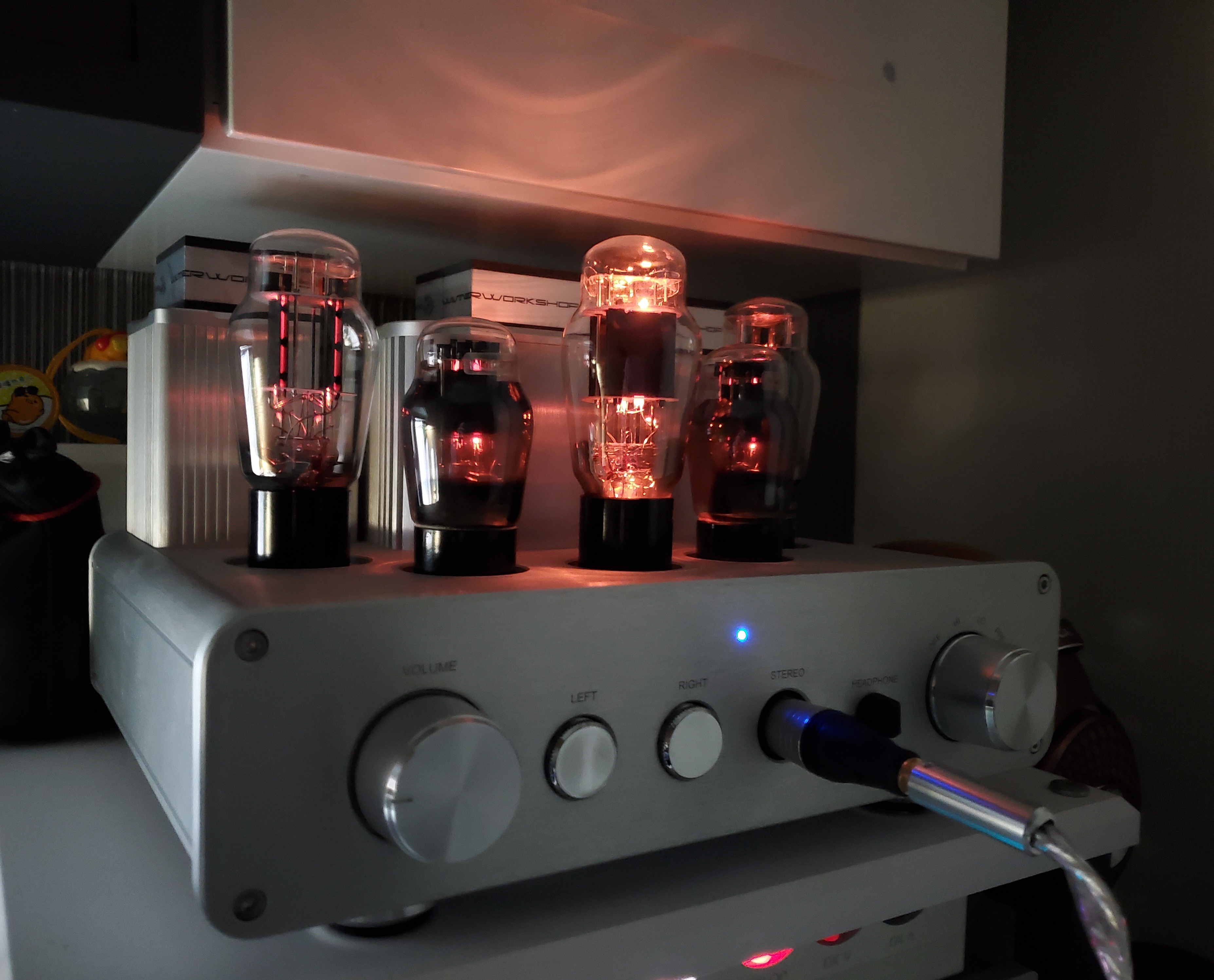

I picked up a used WA22 on Headfi and love it. I also use the USAF rectifier and can confirm it made a huge improvement over both EML and Sophia Electric 274B. I also realized this amp is hugely sensitive to the quality of power. If I plug it into a regular outlet in my house I get hum and noise. If I plug it into my PS Audio P5 connected to a dedicated power line for my hifi set-up, it is dead quiet. I started to play with the Linlai Elite 6AS7 and really like them. Have a pair of NOS 6AS7G Tung-Sol Chatham 1955 coming from Holland, very excited.
