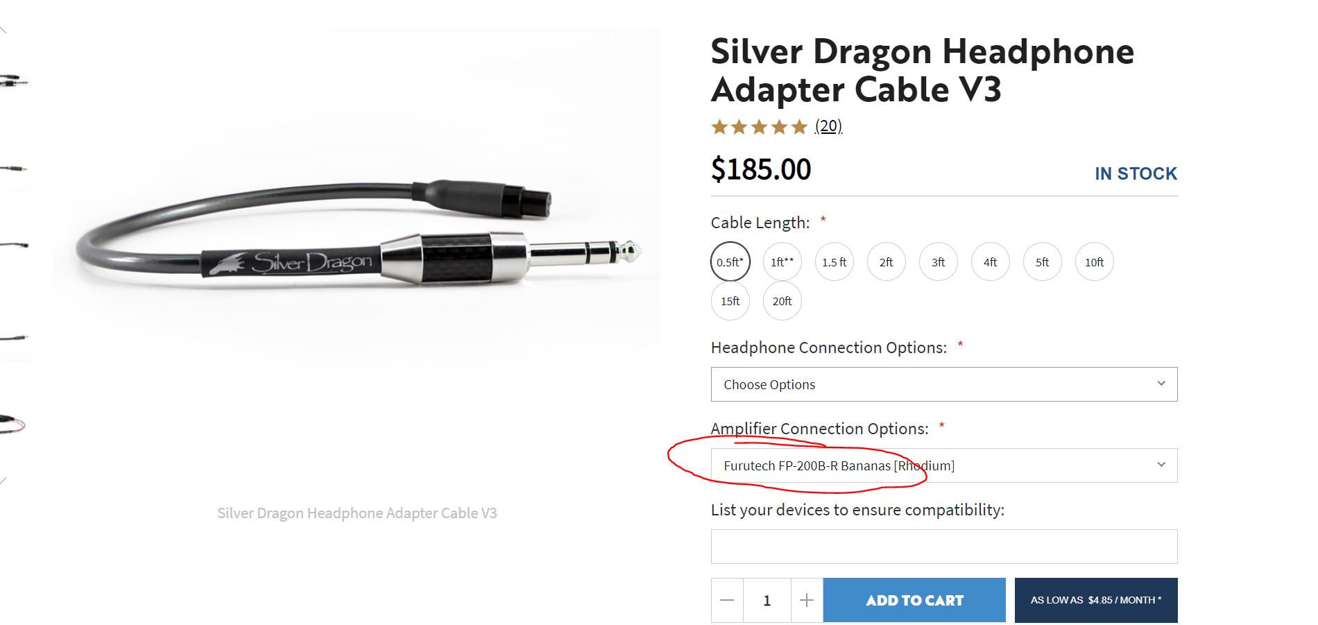

You can try to use the taps on the back to run the headphones. That might work out better than the headphone jack if that sub system isn't up to the level of the rest of the unit.
Most places making headphone cables will give you can option to use banana. (but an adaptor cable vs a full run might be the better option.)
(costly option from moon-audio as a random example)
we are also on the right forum to ask about stuff like that too :)
what headphones are you using and connection on them?
