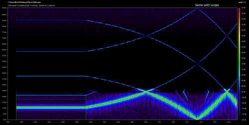

I've messed around with some of the settings on my computer (without really knowing what I was doing) when I tried to play back some supposedly high-resolution audio and measured the output of my soundcard. The way I set up windows/foobar absolutely made measurable differences, sometimes even audible like not working at all or cracking while playing back music.
Maybe that was because of "messing around without knowing what you were doing" then.
Instead of just telling of those results you got, to back up, it would be good to post some graphs of results and info of methods/settings used and info of HW used.

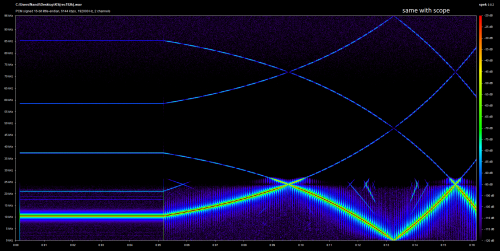

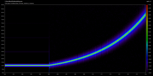

VNandor
Oct 17, 2014
543
213
Sure, I have an STX soundcard. The driver was set to 192kHz. Windows is also set to 192kHz, both the playback and recording.
I connected the output of the sound card to the input, and I also used an analogue oscilloscope to measure the output directly (so the signal wouldn't go through an A/D conversion).
This is the file I was playing with foobar:
Foobar's output set to primary sound driver:
Output set to kernel streaming, wasapi was identical to this:
Output set to ASIO:
At the time I had xonar essence stx asio, fl studio asio and asio4all and I don't remember which one I was using.
There's also those notes about the oscilloscope, the same with scope note means that I've seen the signal to sweep up and then back down with mostly a constant amplitude except for the highest and lowest frequencies, the amplitudes dropped there.
Anyways, I'm not sure about the WASAPI vs ASIO thing but misconfiguration can certainly cause some problems and if someone makes changes without really knowing what's going on, they are likely to run into it.
My guess is that an incorrect setup might make asio and wasapi work differently but with a correct setup they are probably identical.
