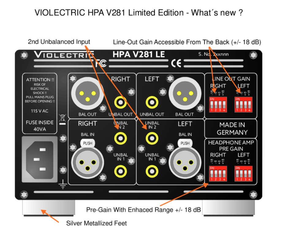

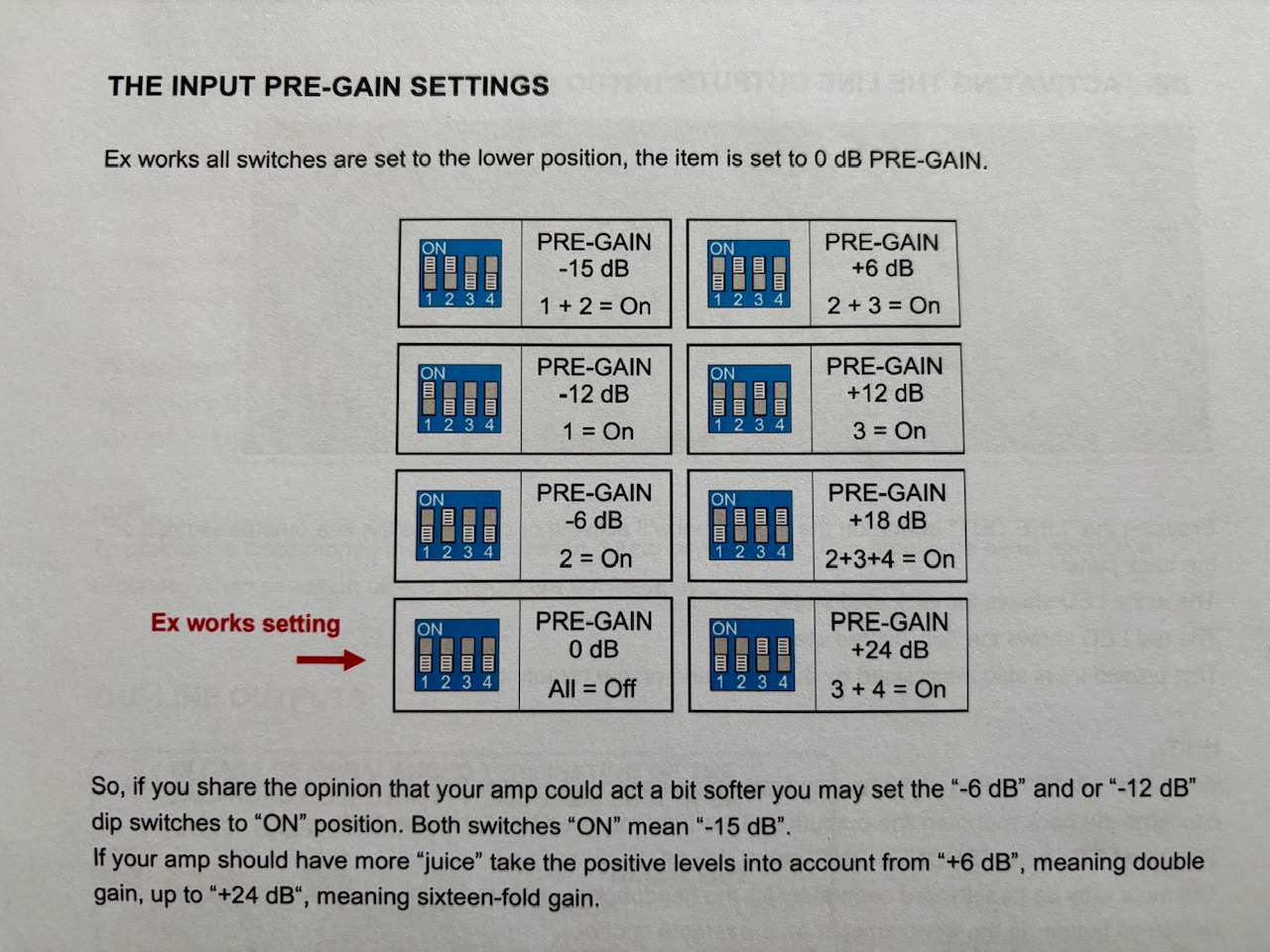

Random question: i am using the v281 as a pre-amp for my Stax 717 so I have remote control volume control, therefore I have the v281 setup to run as a pre-amp pre-fader so it's volume pot controls the 717.
I recently purchased some LCD-4s which are power hungry and I've found sound best with pre-gain set to +12db. But, if the v281 is set up pre-fader as a pre-amp, does the pre-gain affect the line level outputs I'm sending to the stax717? Concerned the signal would be too hot if it did, and worried about trying it and overloading the Stax.
If anyone has experience with a setup in a similar configuration and can advise, it would be greatly appreciated!

The pre-gain jumper only affects the front headphone outputs. The line output splits off before the pre-gain, as shown on Page 13 of the manual.
http://violectric-usa.com/download/Violectric V281 Manual.pdf
Inside the V281 chassis there is a "Line Output Gain level adaption" jumpers that can be adjusted between -12, -6, 0, +6, +12 dB.
You shouldn't need to change that, since the factory default is 0dB, which means it is unity gain on the line output.
That means the volume knob acts as an attenuator only, so if you crank up the volume knob all the way to the max, it should achieve a level that is equivalent to the input RCA signal. You just have to be careful that you don't accidentally blow up any headphones connected to the front of V281....
Whether the Stax gets overloaded or not will depend on what RCA output voltage is pushed out from the upstream source that connects into the V281.
