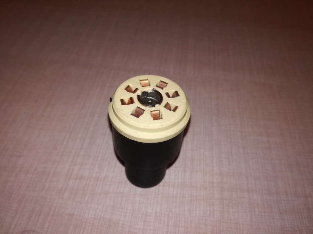

Just had one made for me by @Deyan . Haven't received it yet but from the pictures he sent the workmanship looks to be first rate. He's in Bulgaria so you'll have to wait a bit on the shipping. Mine is intended for the Vali 2 with a 7N7 on top rather than a 6SN7, but I believe he can configure an adapter for whatever you want. I like the one piece body on this which eliminates the need for a socket saver or extension (and more connections as a result). PM him if you have any interest.
Looks nice. Any mention on how tall is it? I'd like to keep it as low profile as possible - you know, for wind resistance & centre of gravity
No mention of the total height. Be happy to measure it and post the info once I get it. I need a fairly low profile myself, due more to felines and the space I'm allotted in the living room for my HP stuff. And it'll get even more restricted when I finish the Schiit rack whose design I blatantly ripped off from @Paladin79 . I *did* thank him though. :slight_smile:
