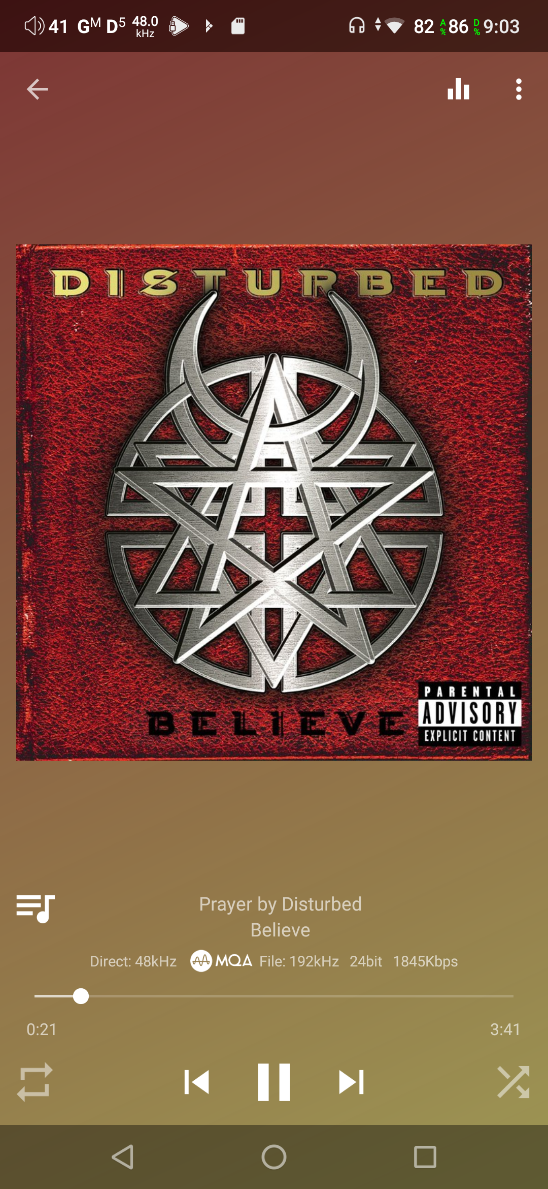

Hey everyone! I've been scouring these forums for an answer for what I am seeing with MQA files in UAPP vs. TIDAL. I've seen many posts where the reported KHz in the info bar at the top of the screen is different in each app. I occasionally see a post where someone reports it is working fine for them (even on the same DAP I'm using). Obviously this is confusing, but here is an example of what UAPP reports:
This is the same track in TIDAL:
This is on the iBasso DX300, but I see the same on the Shanling M8. I've tried various UAPP settings that I have seen posted, but they don't make a difference. Note that while it shouldn't matter for these DAPs, I do have the MQA add-on for UAPP.
So, am I doing something wrong? Are these DAPs just not fully supported yet?

Are you using any EQ in UAPP? If you use the EQ functions, I don't think UAPP will be able to render full MQA.Hey everyone! I've been scouring these forums for an answer for what I am seeing with MQA files in UAPP vs. TIDAL. I've seen many posts where the reported KHz in the info bar at the top of the screen is different in each app. I occasionally see a post where someone reports it is working fine for them (even on the same DAP I'm using). Obviously this is confusing, but here is an example of what UAPP reports:
