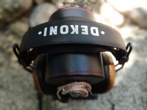

Dekoni Blue
I am also going to use a Dekoni Blue as the base as it has black rails and a nicer headband. The standard headband actually looks great with the off color silver.

1. I assembled the pivot pieces with the supplied screws.
2. I use heat shrink and heated on one end then pulled it through and affixed with some hot glue.
I also add the pivot cover this one here is from the v1 tuning kit, the v2/3 is more open.
3. Note this section that surrounds the driver is from the v1 tuning kit, I would like to see it re-added.
4. Driver fitted with the original screws and one layer of felt and then covered with the baffle foam. I advise testing this with or without before committing to the foam as it secures the felt in place and once it's on it's staying on.
5. Headband and Modhouse Audio strap fitted.
6. Wires soldered into place.
7. Snipped fiber insert about halfway through at the front so it fits around the cable, not all the way through. I also suggest adding a layer of felt behind the fiber. The tuning is open to each individual. I am still experimenting myself.
8. I used #4 x 1/2" screws not supplied to fit the baffle piece to the wood, this took a few goes and a bit of work as the baffle piece kept rising up so once you have the holes made then drive it home on a second time holding it firmly in place.
