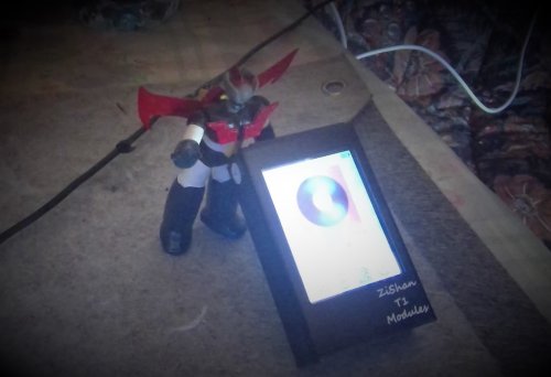

  4. neog007
    Bought the zishan t1. Previously the f.audio xs03. Both with ak4493x2 BO.
    Still prefer the sound of the DSD in LO.
    For balanced I prefer the f.audio over the T1, but this can change since the f.audio has no upgradeable oamp option.
    T1 is difficult to manage compared with the DSD. Not only for the resistive screen´s quality but with so few options touch screen was totally inconvenient with stock firmware, but I guess those who will install rockbox will appreciate it a lot.
    Curious about the evolution and modding of the new player though, in particular if it will be a ak4497x2 module in the future.
