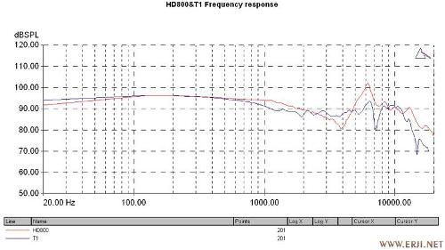

I believe that while this comparison is good spirited, it is not really useful and ends up being really skewed.
For instance, neglecting the THD, which I have always found too inconsistent to be reliable, the hd800 and the t1 would be equally good using your own criteria and THIS data:
http://graphs.headphone.com/graphCompare.php?graphType=-2&graphID[]=2033&graphID[]=4061&scale=30
In fact this graph makes the hd800 to appear "peakier". It doesnt looks like an A vs D case any more!
Your idea is good, but if the measurements are all over the place you cant really make any conclusions. In addition, I find the criteria to be insufficient (where is a REAL test for linearity other than the THD?) and the quantification of the attributes rather simplistic (basically a binary system!).
I hope this, otherwise nice, contribution is taken as a proof of concept thing and no as a real-world usable conclusion. Sustaining harsh and definitive comments as the ones the author makes regarding the HP companies with this document is rather silly, even if they may be true.
PS dont any of you dare bringing those waterfall plots into the hd800's aid, the author himself discredited them in his own article due to the inconsistent measurements :wink:
