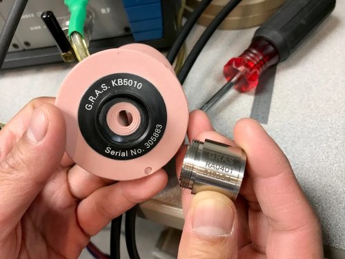

A few weeks ago, GRAS announced still another coupler designed specifically for measuring high-resolution headphones. On Friday (two days ago) we took delivery of the new GRAS RA0401 High Resolution Ear Simulators, and we'll be installing them on our GRAS 45CA, along with the new anthropometric pinnae for the GRAS 45CA.
GRAS-Anthropometric-Pinna_IMG_0156.jpg GRAS-Anthropometric-Pinna-and-GRAS-RA0401_IMG_0159.jpg
This is still another very exciting development for headphone measurements, as obtaining meaningful measurements above 8 kHz with most systems can be enormously challenging. This new GRAS RA0401 High Resolution Ear Simulator also meets the IEC 60318-4 tolerances, but GRAS was able to design it so that its performance from 10 kHz to 20 kHz is substantially improved, that range through which it has a tolerance of +/- 2.2 dB. Here is a graph showing the RA0401's response (including the IEC 60318-4 tolerances) compared to a standard 60318-4 coupler:
Again, meaningful headphone measurements above 8 kHz or 10 kHz have been a major pain point for decades, so I think these new GRAS High Resolution Ear Simulators may prove an important development in the world of headphone testing.
Unfortunately, we haven't had a chance to run our own measurements with the new RA0401 High Resolution Ear Simulators yet, as we shipped our measurement mic preamp power supply back to GRAS for a check-up and any necessary calibration (as it's now nearly three years old, and has been jostled around quite a bit). We should have that (GRAS 12AQ) back in the next few days, and we'll fire up these newest ear simulators just as soon as we do.

  • Always using same DAC and amp set-up with impedance under 1 ohm
  • Always using same ARTA set-up , same settings
  • Always use same foam tips - medium bore setting. I use these primarily because with silicone it is impossible to get consistency in the coupler
  • Always use approx same tip depth and orientation (and this is as upright/ straight into the couple as I can get)
  • Always use it at night in essentially a very quiet room with no fans or other disturbances
  • Always measure multiple times until I can get consistently repeatable results
  • The calibration was done using exactly the same IEM on a fully calibrated IEC set-up and then applying compensation to equate the two measurements. Like I said earlier, it has been quite gratifying to get feedback from more than one source that my curves are not too far away from one of the industrial rigs being used.
I certainly believe there is a place for the hobbyist, and would encourage those participating to continue what they are doing, and strive for more accuracy over time. Until such time as you start measuring all the gear out there (including a lot of the budget stuff), the hobbyist set-ups are going to be the only way to check between some of the very subjective opinions out there, and a more measured objective approach.
Last point - I don’t generally use my rig for full sized earphones (so the Pinna does really not come into play) - simply because I could never have any degree of accuracy. I do see some affordable alternatives out there - so it’s exciting to think this could also help standardise the measurements of full sized headphones and earbuds
https://www.minidsp.com/products/acoustic-measurement/ears-headphone-jig
