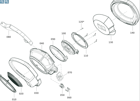

Shouldn't replacement parts be the same as for HD800S?
Feb 8, 2019 at 12:29 AM Post #27,139 of 28,989
Those metal grill covers (#020 if this is what you are referring to) are p/n 533369 and the last time I checked the price it was ≈ $14 each.
I have 2 sets that I have removed from my 800's, so if you want a set let me know and we can work out the details.
But I'd also suggest as a possibility, if SQ is high on your priority list , to remove them and see if there is any change for the better, or not.
JJ

Yeah I saw that picture but I couldn't find a link to actually buy that part by itself. Do you know where exactly on the site you can buy it?
I'm open to SQ improvements, what is the difference with the grills off? First time I've heard of that making a difference to the sound quality.
