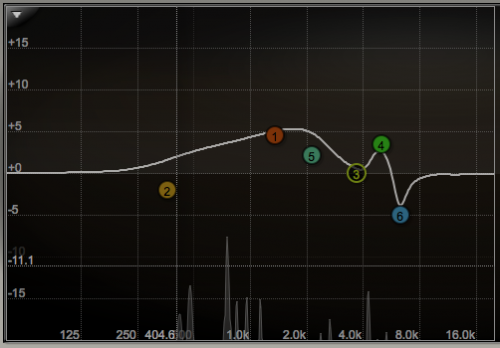

Since no one else has responded, I'll chime in with what I came up with.
I use Tone Boosters TB FLX4 and TB FLX which are parametric EQ plugins that have been installed in Media Center in the DSP Studio section.
I have written up the settings I use and posted them here, along with a couple of 'companion' tweaks that dovetail well with the EQ I'm (and others) are using.
https://www.head-fi.org/threads/the-diyrs-cookbook.781268/page-15#post_12300653
https://www.head-fi.org/threads/the-diyrs-cookbook.781268/page-24#post_12489775
But by itself Sonarworks is a really good introduction into what is possible using EQ, and what I've done, using the Tone Boosters EQ, is to 'adjust' the FR curve of my 800's to be closer to flat and along with adding the SSBB, which brings up the extreme bottom end all the way up to ≈ 100Hz, the results are most gratifying.
JJ
Thank you so much for that feedback!
Would the resultant EQ settings effectively look like this?
Hz Gain Q
12 +16 0.55
60 +2.0 4.0
362 -2.0 1.29
1358 +4.5 0.98
2130 +2.1 2.12
3556 -0.8 5.0
5023 +3.5 5.0
6306 -5.0 5.0
14550 -4.3 5.0
Reactions: Ethereal Sound
post-14599768
Post #26,981 of 28,264
johnjen
Apr 13, 2010
3,052
2,197
Well Grounded, here and now
Apr 13, 2010
3,052
2,197
It looks like this
And what you don't see is that this is running with a wet/dry mix of 90% (which I'm still fussing with, to dial it in).
This curve is fairly closely matched to what my 800's 'need' as a set of not just corrections but enhancements as well, (think the harmon curves) and a good portion of other EQ adjustments are handled by separate DSP functions so they aren't shown in this one parametric EQ graph.
And I started with an actual curve of my 800's so this curve is actually closely matched to how my 800's actually perform.
I have found that DSP is actually, when used well, quite handy at a variety of audio tweaks.
Think SSBB and PRT and clipping monitor etc.
JJ
