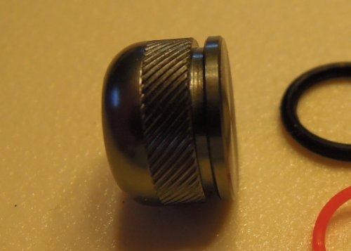

I was going to just order a different 13mm knob, nicely knurled like the E12A's knob. But upon closer inspection of the stock A5's knob, the red 'stripe' (which I originally thought was painted on) turned out to be a thin red rubber o-ring.
Well, all you do is remove the red o-ring (using your fingernail or the point of a sharp object like a sewing needle). Here's what you're left with:
(Note you DO NOT have to remove the knob itself. I only removed it when I thought I was going to replace the knob. To do this mod, you can leave the knob on.)
Anyways, once the red o-ring is removed, I found a similarly sized (but just a tad thicker) o-ring, and reinstalled it back onto the knob. The results are a nice grippy rubber surface that allows the knob to be turned with ease. A vast improvement over the stock knob!
Here's the finished product:
Note how the new o-ring is thicker, protruding from the edge more than the stock red one did. This is what provides the grip for your fingers.
