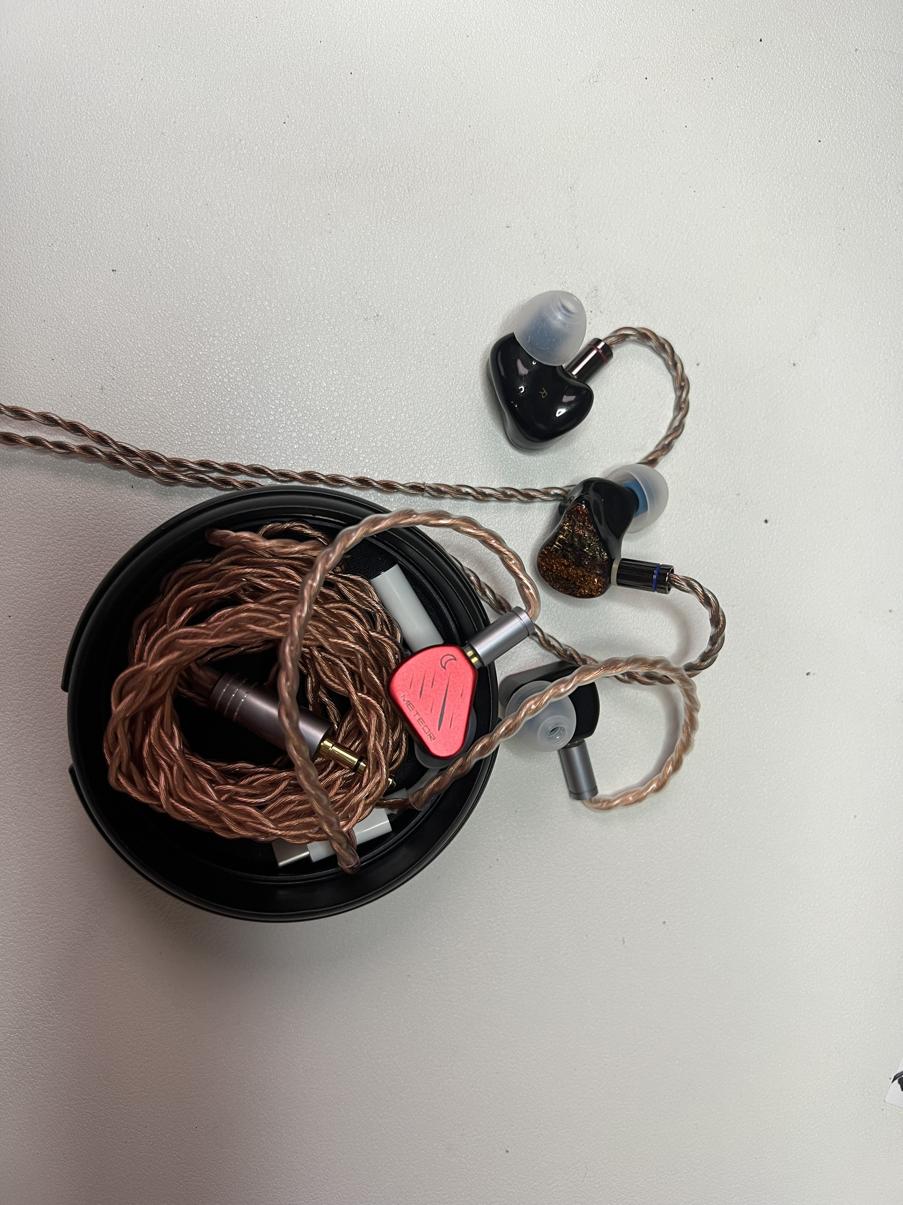

You need blue cables to fully enjoyHere is my ESX with a colour matching cable from XINHS (blue color is the best for electronsIn blue cables my Hi-Fi trust stands )
