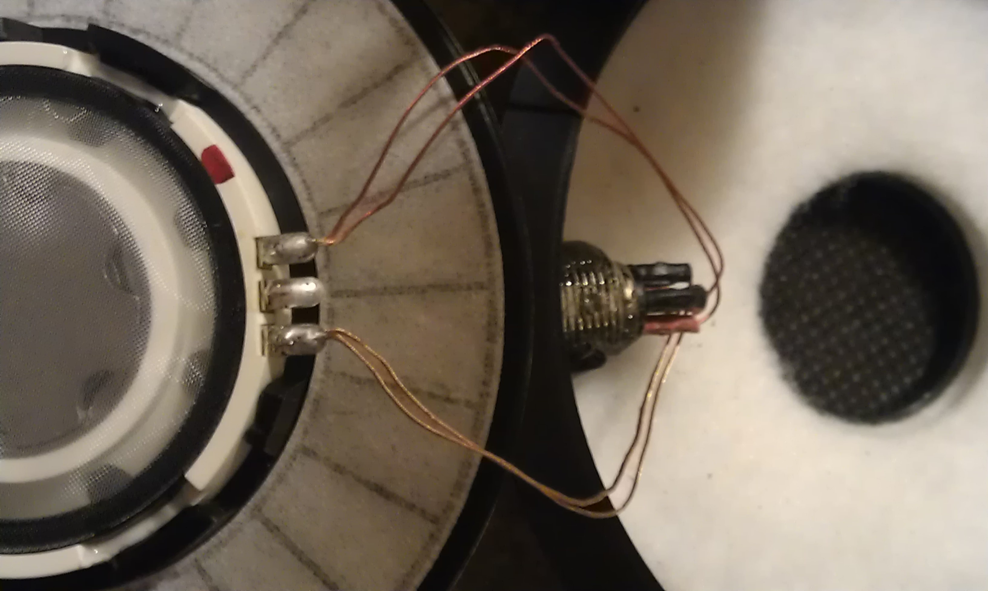

Do you have experience with a soldering iron? From what I have heard, doing the detachable cable mod is rather easy with little soldering experience.
Might save you some bucks and some waiting time.
Cheers
No, none. I’d like to get some though.
You have to be extremely careful when soldering on DT880 drivers. The three tabs on the left are just press fit into the plastic and can be pulled out very easily once heated with the soldering iron.
If you do pull one out by accident, you will have snapped the voice coil wire attached to the bottom of the tab and that will render the driver useless. But, if you are lucky enough, there will be a few mm of the voice coil wire left sticking out so it could be attached to the middle tab.

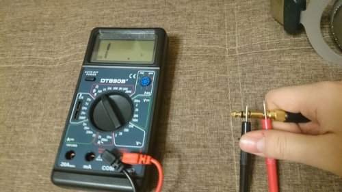

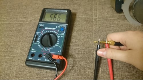

Hello guys, i recently got my DT880 600ohm edition from Germany but one thing is bothering me: all the 600ohm reviewers state their cable has that "600Ω" sign before a jack, but mine has not! The package also says it's 600ohm (but doesn't have that "Audiophile 600ohm version" sticker). And now i worry if they sent me 250ohm instead of 600ohm version or is it just the new revision or something... What do you think?
On the inside of my 880 it tells me which ohm the headphones.

I believe you can check with a multi meter.

So what amp and/or dac do you have? What is the max watts it can put out @ 600 ohm? The difference between 250 oms and 600 is HUGE.
I had Fostex HP-A3 in the past but now I ordered o2/odac combo specially for my new DT880, o2 must put 88mw to 600ohm, I hope it will arrive soon
So, I used my multimeter and 200ohm mode didnt show anything (but measured 35 ohm on my 40ohm headphones). The 2k ohm mode says it's 0.560-570 kOhm that i guess is about 600ohm right? Sorry i'm a noob at this.
