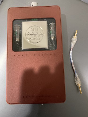

3210D301-98CC-48E0-B67D-4CA506873BFB.jpeg C71DE440-05BE-40B3-9F20-EF93CF769ED8.jpeg Hi CDM owners,
I had a chance to get a CDM during BF sale and got it yesterday but when open the box and look at this gorgeous toy I found only one short adapter (one end goes to CDM other end is going to the source as DAP I believe). Do you know what DAPs do have sockets fit that end?
For example, I am using with A&K SR15 which does not have any sockets can be used with that adapter. Any suggestions with available DAP or other adapters as well would be appreciated? Thank you.

The short cable is a 2.5mm trrs balanced cable. Most Astell and Kern DAP have this balance output.
You can always use any 3.5mm cable to rca or else. CDM has 2 inputs

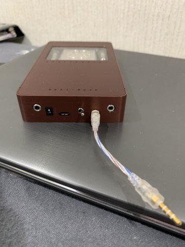

When I connected the CDM 2.5 input to the SR15 2.5 output I listened to 2.5 CIEM UM Miracle and can barely hear the sound only the right side with the max volume.
There is a switch on the back that should be switched to the left for the analogue inputs and to the right for the USB digital input, check to make sure your switch is set to the left.
Also make sure that all cables are fully seated. Especially with brand new devices, sometimes it's hard to tell.
