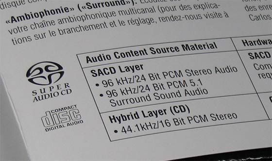

Yes SACD format is encoded in DSD. The figures quoted (24/96) are the equivalent LPCM numbers, otherwise they'd have absolutly no meaning. DSD data works quite differently from wav.
