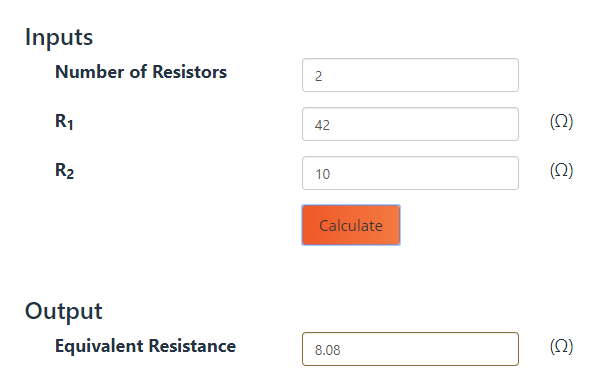

How did you calculate the resistance load based on the headphones in use?
Is there a formula?
Thanks again.

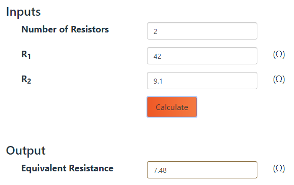

Like this?
The HEDDphone are 42 ohms, Target is 8 ohms for the Sophia Baby.
errs on the side of "too little"
errs on the side of "too much".
Which error is "better"?
[Thank you for your patience.]

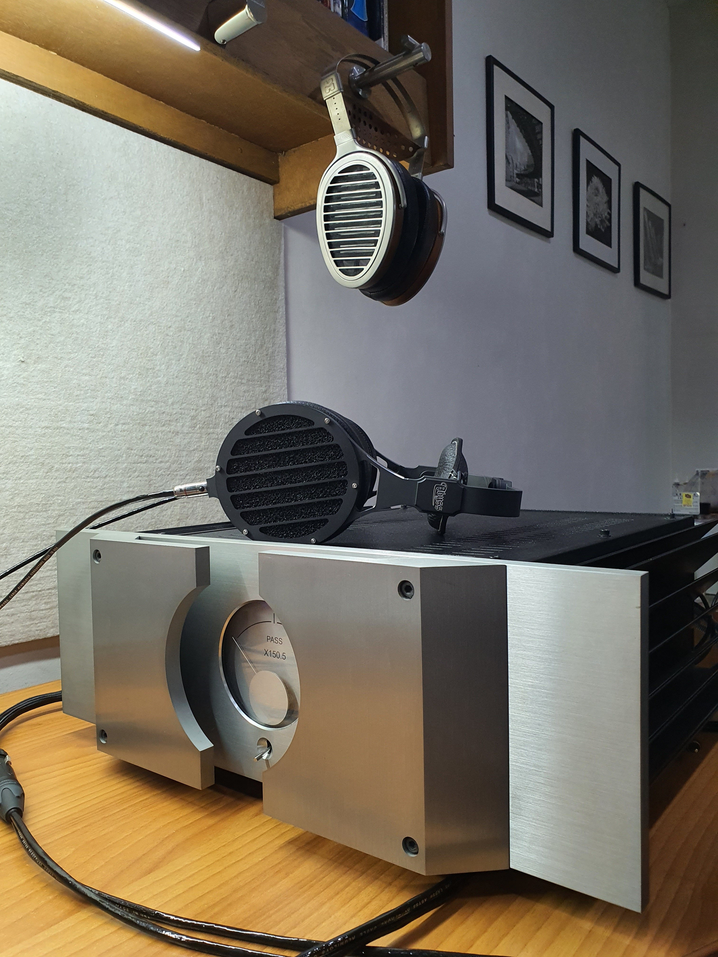

Finally got this underway. After a couple of weeks using conventional headphone amps the Conductor 3R and the Beta22, found the 1266TC's lackluster and really disappointing. I thought it would have at least a decent match with the Burson, but for all its 6W the TCs seemed underpowered (no dynamics, no detail, overly warm). Plugged the TC into my stereo setup (Cantata CD/DAC > Pass XP10 > X150.5 via XLRs) using the Furutech adapter, the sound seemed too loud (too much gain?).
I am now testing the following configurations:
Burson C3R (as DAC-preamp) > X150.5 > 1266TC via RCA - better than all the above setups, skipping the XP10 preamp and running the Burson direct to the X150.5 seems to have scaled the power to the level of the headphones (not sure if that makes sense). It also let the ESS DAC shine with it's detail and resolution, with the power of the amp that just totally controlled the TCs - very good dynamics, deep impactful bass.
Cantata (as DAC-preamp) > X150.5 > 1266TC via XLR - the Cantata and the balanced connection outperformed significantly the Burson C3R setup. Replacing the technical ESS sound with R2R musicality while matching the detail and resolution. This is the best configuraion I've tried yet for the TCs and I'm finally able to experience the Abyss sound that I've read so much about.
So far I've been fortunate to have 2 DACs which have pre-amp functions allowing me this direct to amp configuration. Having all this clean power at the disposal of the DAC really shows the character and strengths of the source and the 1266TC's are really able to sing. Volume has not gone beyond 40 in both cases. I'm not sure I would still be exploring dedicated headphone amps for the TCs having experienced what a real good amp can do with it. I doubt even the Formula S or the HPA 4 can deliver this kind of control of the drivers, natural sounding visceral bass and almost stereo-like soundstaging. I'm looking more towards upgrading to an XA25 (20W Class A) or a First Watt F7, for even better transparency and musicality but because this doubles as the amp for my stereo, that won't be happening until I can switch to high-efficiency speakers.

Yes, just get 2 10-ohm resistors, 1/channel.
Thank you very much!
Hope I didn't damage the transformers in a 3 hour fit of wreckless abandon!

wuhere, kid vic, et al,
Picked up two [generic] 10 ohm resistors [to tide me over until the Mills arrive] and hooked them up.
Everything sounds a lot better. Bass response is now phenomenal and things don't sound so "hot" and overly laser-focused.
I am so impressed, and so grateful, and so relieved!
Thankee, everyone!
