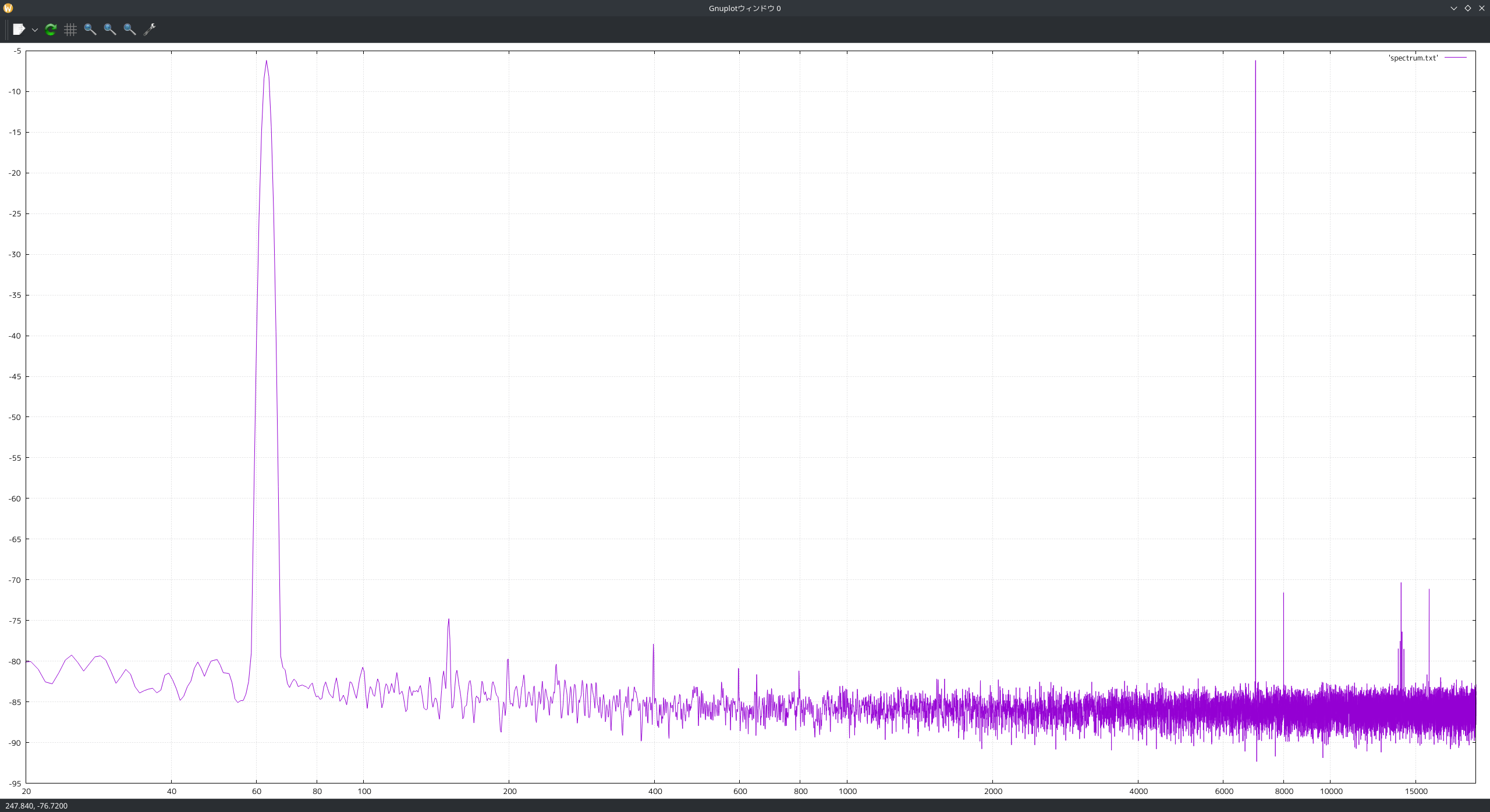

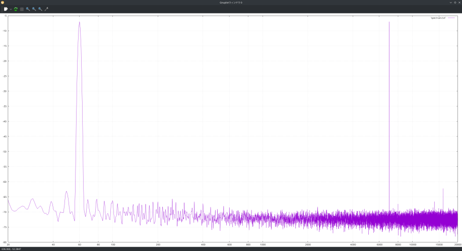

First of all, i can no longer hear the distortion at -80db. Surprise surprise. When i tested it earlier, i forgot to increase the PC volume back to 100%.
Now the PC Volume is back to 100% and i hear no distortion at -80db on the DAC, it sounds perfectly fine.
But the SNR seems to be much better. This here is THD+N at -80db on the DAC
This here is IMD
I assume both measurements are limited by my DI
For Comparison, this is how it looks at 0db
And for the Ultimate, definitive fun, here is -95db (Again, pretty sure SNR is limited by my DI)
So i take everything back, there is no distortion issue, even at -95db...
Hard to tell from FFT but if it is 32K point FFT then it seems to be about 8 or 9 bits of dynamic range/SNR. Here's 32K FFT of full scale signal at 8-bit / 44.1k sampling rate, for comparison:
