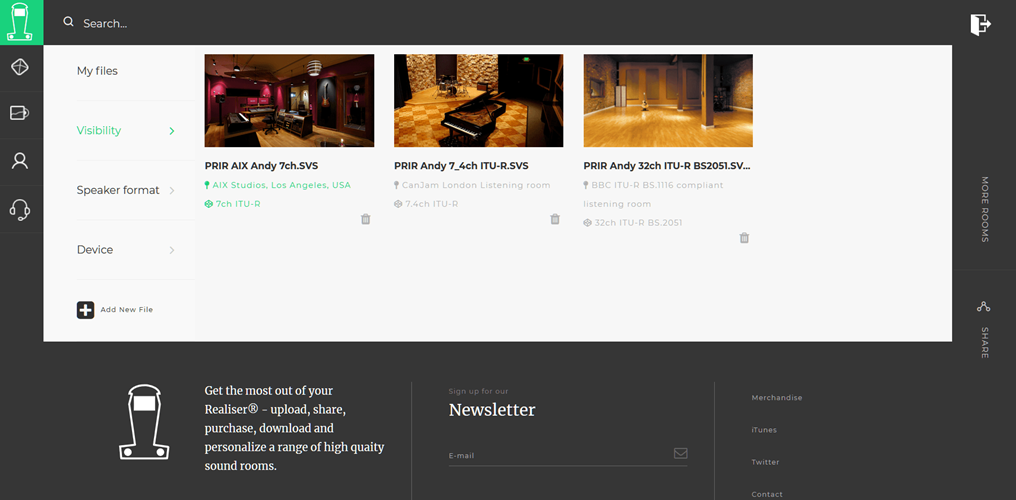

I went to look at the Smyth Research site and stumbled accross something at the bottom of the home page under "Realiser Exchange" heading :
Was it always there ? I must have missed it because I always went to the Exchange page where nothing of the kind is available.
Nothing to get excited about. A long time ago on the exchange page itself you could see a few rooms (with prices even). In the beginning it seemed Smyth had the site live online - but not ready for use - while under development. At some point they just left the static "empty" version online that is visible now. Meanwhile developing further offline (I hope).
Another one of the things on their punch list.
