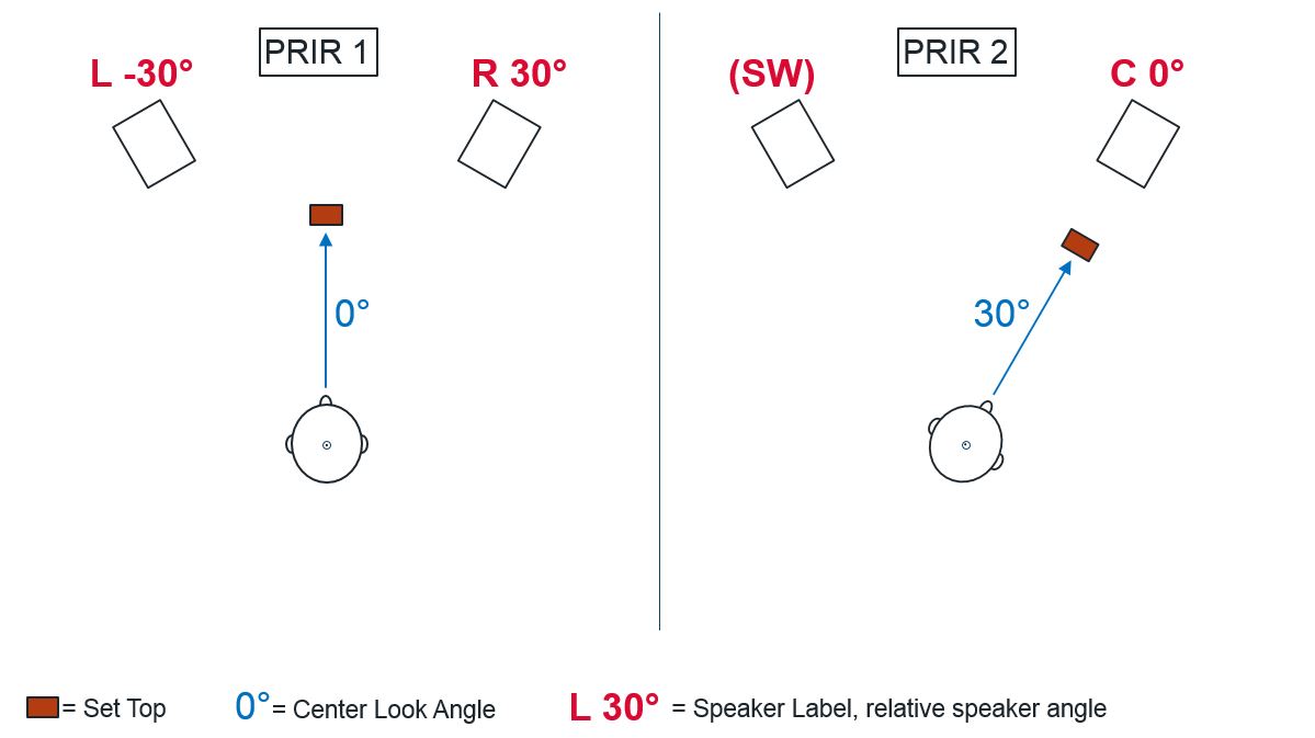

Here are the pictures I promised, how you can create 12 speakers, one ever 30° with 2 speakers and keep the correct angle and distance and the listener in the sweet spot all the time.
We use the HT guided method to achieve the correct look angles, so the head top has to be repositioned also.
Or as I already said one can also try to rotate the head top on top of the headband of the listener and keep the set top always in the front middle.
We will try this and I try to manufacture a rotatable adapter that can be set to precise angles with an angle measurement tool ( https://www.amazon.de/gp/product/B000X2FU0U/ref=ppx_yo_dt_b_asin_title_o00_s00?ie=UTF8&psc=1 )
