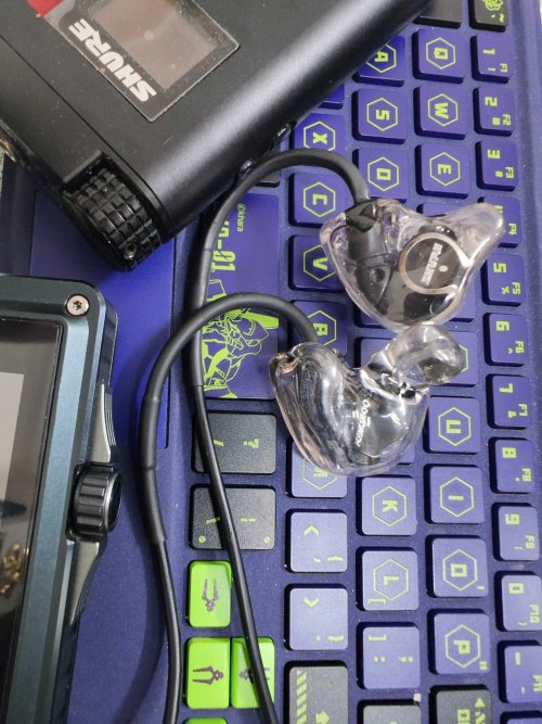

Dec 22, 2024 at 10:02 AM Post #6,243 of 6,288
I'm curious what's wrong with that earphone?
Drivers are no more useable?
these are unused cases
these are not earphones
there are no drivers inside
I bought the cases separately
but never used them
maybe now they will be useful to someone
