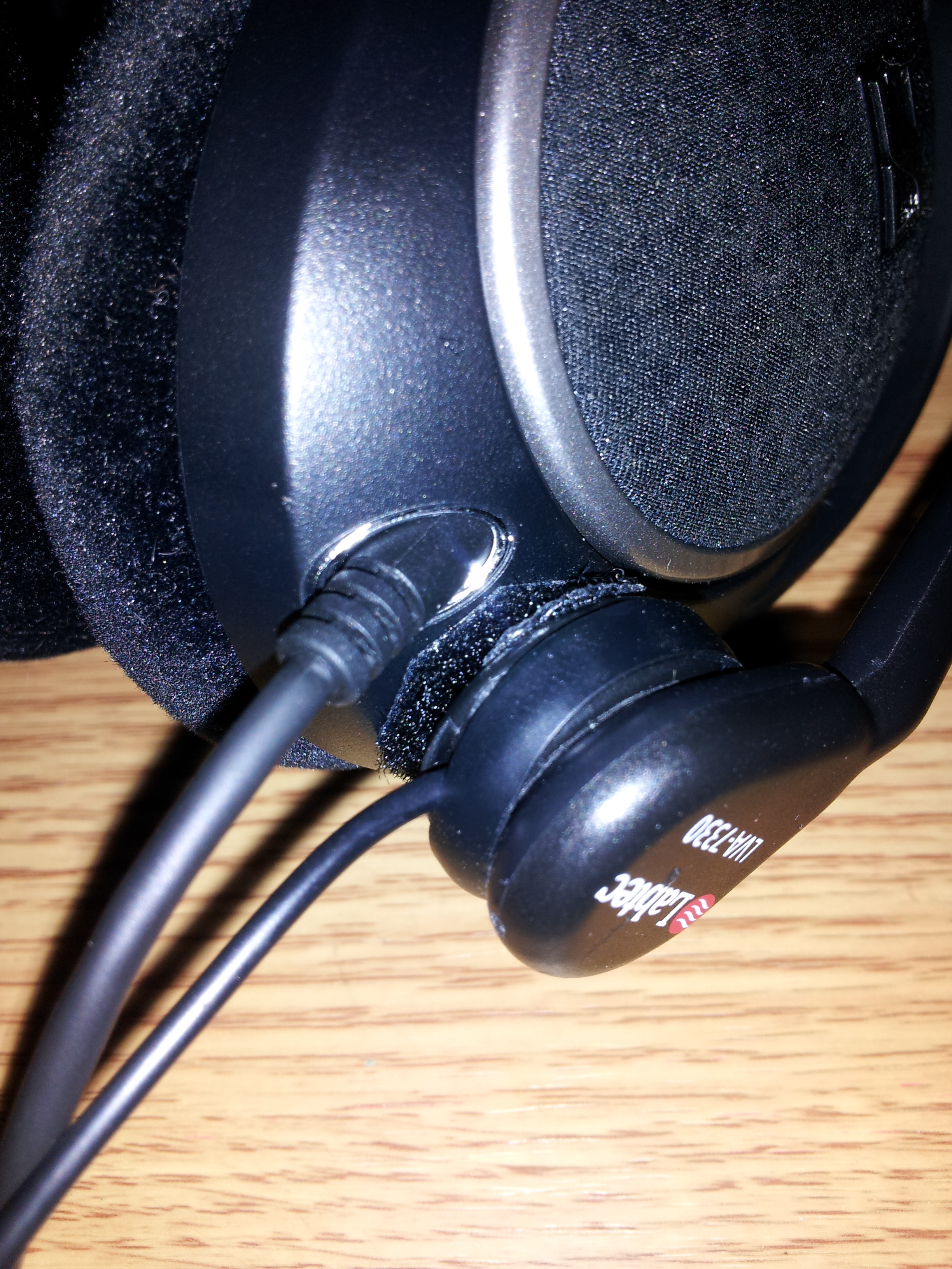

I decided to go ahead and take some pictures of it. I am planning on using this for a gaming headset so there is a mic attached to the side of it.  If the pictures are too big let me know and I will resize them.
Here is the headset with the test cable and mic.
This is the cable I used for right now to test with. It is the XBox 360 chat cable that came with my Astro Mixamp.
Remove the 4 screws shown here and then the plastic locking piece will come out. After the locking ring is removed screw the PCB back in place.
this is the piece you want to remove
Reactions: Rocko1

I found an adapter on ebay that fits perfect once you remove the locking ring.  Here is the ebay link, and a picture of the adapter.  I just got it in from china but is an exact fit. it is a 3.5mm stereo female to 2.5mm male 4 pole adapter. Ignore the velcro in the pic, that is for my labtec mic so I can use the headphones while gaming.
http://www.ebay.com/itm/260954472351?ssPageName=STRK:MEWNX:IT&_trksid=p3984.m1497.l2649
