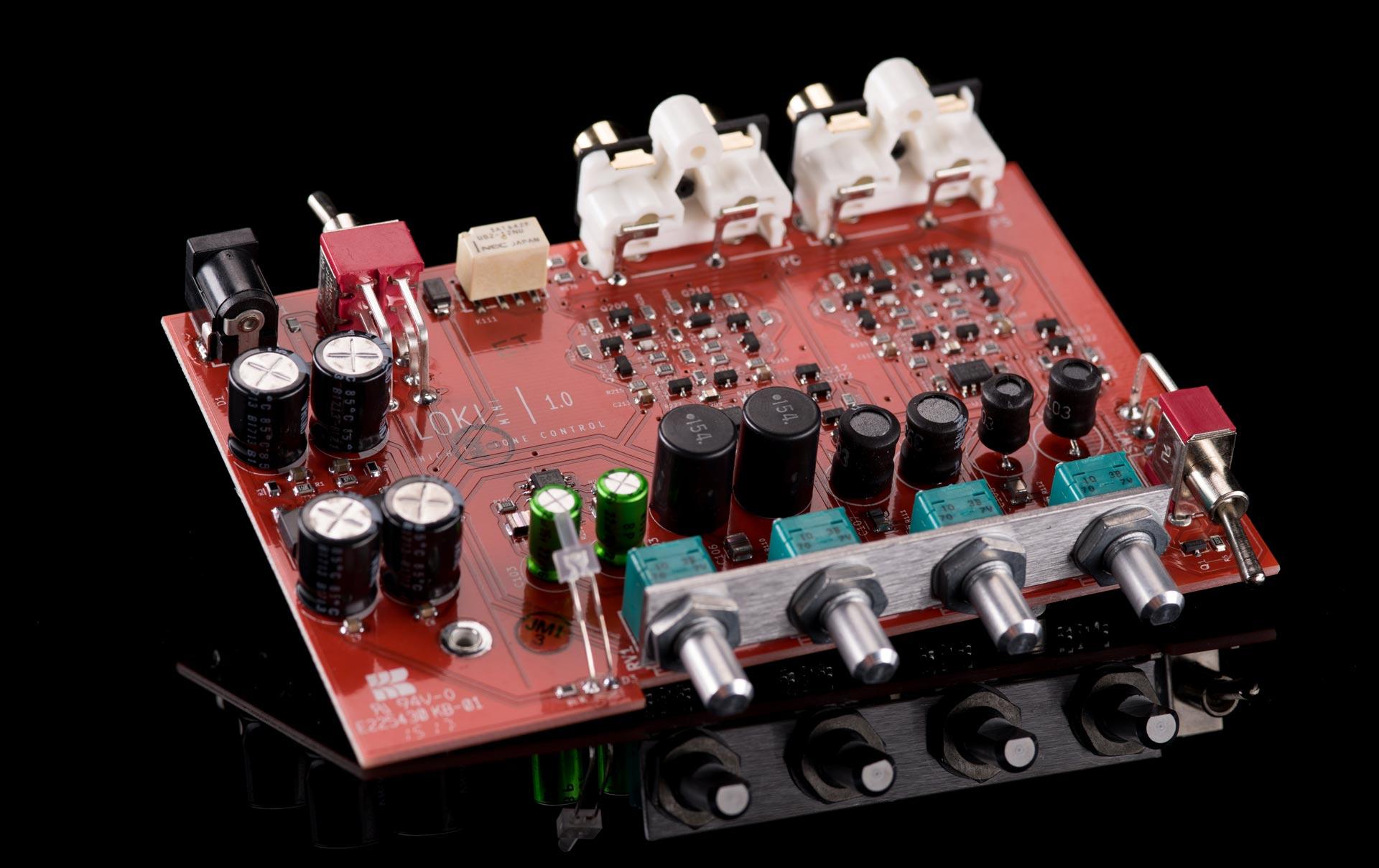

Loki Mini press release just released on Schiit's site.
Schiit Introduces Affordable, Discrete, LC-Filtered Hardware EQ for $149
September 26, 2017, Valencia, CA. Today, Schiit introduced Loki Mini, a compact, high-performance, 4-band hardware equalizer designed for excellent sound quality.
“It’s time to bring tone control back to high end,” said Jason Stoddard, Schiit Audio’s Co-Founder. “No transducer is perfect. No recording is perfect. And some listeners want to tailor their sound to their preferences. Now, they can do that with maximum transparency.”
Unlike old-school EQs of the 1980s, which and frequently had problems with noise from stacks of op-amp gain stages and open-frame slider controls, Loki Mini is designed for superior sound. A single, fully-discrete gain stage and a single discrete buffer per channel is coupled with sealed Alps potentiometers, a 100% linear power supply with +/-18V rails, and LC (inductor-capacitor) filtering to keep performance high and noise low.
Loki Mini also features gentle control and rational ranges to allow for precise and subtle tonal alterations. Potentiometers are progressive, so that a full 30 degrees is needed for the first dB of boost or cut. Loki Mini offers adjustment center frequencies of 20 Hz, 400 Hz, 2kHz, and 8kHz. 20Hz and 8kHz offer +/-12dB of adjustment, while 400Hz and 2kHz offer +/-6dB.
Loki Mini also offers a true bypass switch—one that simply connects the input to the output, with no intervening circuitry. The front-mounted switch allows users to compare the processed output to the “flat” output instantaneously.
“We understand that many still consider tone controls anathema in the high end, but we feel that Loki Mini provides meaningful control and flexibility, without significantly affecting transparency, ” said Jason Stoddard. “We decided to start the Loki project when we introduced our first preamps. A surprising number of prospective customers asked about tone controls, which we initially dismissed. And then we started thinking, ‘wait a minute, once you start dismissing things out of hand, it may be time to reexamine your prejudices.’ So we developed this product, tested it internally and externally, and found many people were thrilled with it. So, now tone control is an option again.”
Note: “Loki” was once used on a defunct Schiit DSD DAC, produced in 2012. The Loki Mini tone control is an all-new, analog product, named for the Norse trickster god.
The Loki Mini is available now at schiit.com for $149."

“Okay, fine, you mentioned you did some prototypes,” the more technical-minded of you are saying. “But how did development go? Was it a nightmare? Loki looks more complicated than stuff you usually do.”
Actually, it was a really interesting development process, one that took us down many new avenues, and one that will pay off well beyond the Loki Mini. And I don’t mean “interesting” in the “wow, it sucked,” way. It was interesting because:
  1. We learned a whole lot about the real-world properties of inductors, a passive electronic component we don’t typically use many of.
  2. We also learned a lot about buffer design, and their interaction with complex loads.
  3. We were able to validate another use for our single-ended current-feedback topology, as used in Vidar and Magni 3.
The main thing we knew, when approaching the design of Loki, was that it was wayyyy different than the stuff we usually made. The goal of an amplifier or preamplifier is to be as accurate as possible—flat frequency response, low noise, low distortion. Loki had the same low noise and low distortion goals, but it was also designed specifically to alter the frequency response.
To do this, it needed a buffer that was linear enough to drive a reactive network that included potentiometers, resistors, capacitors, and inductors, in-between the buffer and the inverting and non-inverting terminals of the gain stage.
Lesson one: when you start connecting simple 2-FET buffers to these kind of networks, things get interesting in a real hurry.
And, in fact, many of our lessons started long before any PCB was ever made for Loki. Early prototypes used potentiometers standing in the air, wired in-between a small buffer board and a Magni 3 prototype. This was just so we could see how the distortion changed in real time, and what the effects of multiple bands were on the overall response, and on the accuracy. Unlike many of our projects, Loki started at the most basic level—the “will it work, and, if it does, what works best.”
In this early stage, we tried a whole lot of different things:
  1. Different gain stages (like ones based on the old Magni, ones based on op-amps, ones based on single transistors, before we finally settled on Magni 3’s basic topology as the best-performing combo.
  2. Different buffers. Hell, I went through a dozen different buffer designs. Dave threw some in the mix as well. Some were completely insane—like the 7-transistor “final boss” load-invariant buffer that was squirreley as hell, and therefore didn’t make it to the end of the road, but performed insanely well when it worked. Think -120dB on 2nd and 3rd harmonic—unloaded, or when loaded with 600 ohms. This is better than the signal generator on our Stanford analyzer. What we ended up with for Loki Mini was an optimized, stacked FET buffer that gives great performance, but is much less insane, and much less complex.
  3. Different inductors. The performance of many small inductors is (ahem) less than ideal. Start driving them and watch the distortion go nuts, even at the 6th, 7th, and 8th harmonics. Scary. We went through a lot of different options before selecting the ones used for Loki Mini.
  4. Different gyrators. Like I mentioned before, big inductors were off the table for Loki Mini—they simply wouldn’t fit. Because of this, we used a simulated inductor (using an op-amp and capacitors) for the lowest frequency band. But even that caused problems with distortion. Switching to a gyrator topology reduced the loading and eliminated the distortion problems. But again, it was something we had to learn.
  5. Different options. Three bands or four? Five? Six? What potentiometers? What chassis? Before we did anything to fit in a chassis, we did a proof of concept board about the size of a Jotunheim with 6 bands, and options for inductors or gyrators for the two lowest bands. It had no protection, no niceties—just something for us to tweak on. We destroyed a couple of these boards working through all the options.
And depending on the options we chose, we had very different products. Lose a couple of bands, do the lowest band with a gyrator, and go to smaller Alps pots, and we had something that would work just fine in a Modi-sized box. This could be a neat, inexpensive way to get a taste of EQ, without spending a ton of money—easily under $200.
Or, go pure LC and put it in a bigger box. Problem with that was that the cost ballooned. The early inductor prototypes were a mess. They ended up having to be re-wound on 80% nickel cores, and they cost more than some of our transformers. You also had to do extreme shielding on the transformer in the bigger box, to keep its field from being picked up by the inductors. That would be a lot more expensive product—maybe on the order of $500, even if we lost one of the bands to eliminate two very expensive inductors.
Or, you could go completely crazy and do a relay-switched stepped potentiometer version, with a true center and precise, repeatable control. You could even do balanced I/O with a Pivot Point style topology. You could do remote control. Heck, you could use motorized potentiometers just to sense the position, and have them all turn when you hit a preset. Of course, something like that would be big (at least the size of Freya) and costly (over $1,000.) Yes, at that point, it might end up being one of the best equalizers ever made, but that was a big ask.
And then, suddenly, I realized, We don’t just have one product. We have a family of products.
That is, if we wanted to go that way. But if introducing one EQ was heresy, introducing three would be lunacy. It would be best to start small, and see if anyone was interested in the product. Hence, Loki Mini.
Aside: will there be other, bigger Lokis? Depends on how the market reacts. Judging from early adopters’ comments on the Loki Mini, I think it will do well. I am much more skeptical about a crazy remote-control, all-LC, balanced in/out device that costs more than $1K.
And, once we decided on starting small, development went relatively quickly. It’s a complicated board—there are lots of parts in a Loki Mini—but other than that, and other than the need for a potentiometer “girdle” that improves pot alignment with the chassis, it went relatively smoothly. Which you might have expected, given all the playing and tweaking we did up-front. Two revs on the PCB and we were ready to place an order. All in all, about a year of dev work. Pretty efficient, when you consider that Jotunheim and Ragnarok took multiple years.
Aside: the name. Yep. I’ll own it. We recycled the name. Quite on purpose, in fact. I always liked the Loki name, and I was sad when it died on the DSD add-on DAC. And Loki the trickster is perhaps the most perfect name, ever, for such a heretical product.
Loki: King?
Of course, there are a ton of you out there, crossing your arms and saying, “Yeah, yeah, yeah, typical Schiit hype. How can something that costs only $149 be good enough to use in a real high-end system?”
Well, at least to my ears, it’s perfectly good enough. We included a real bypass switch on the front panel so you can A-B it instantly. When Loki’s out of the signal path, it’s as out as it can be—as in, the Precious Original only passes through a relay and a resistor. When it’s in and the controls are set flat, it’s also pretty damn flat—the custom Alps pots with a very precise center help with that.
I’ve used Loki to improve the response of headphones I don’t particularly like (sorry, no names here, but let’s just say that some people have been surprised when they’ve walked into my office to see me wearing headphones they thought I’d never tolerate.
I’ve also used Loki in speaker systems, most notably in our old listening area, which was, to put it mildly, quite suboptimal. It made the overall system much more listenable—and more accurate.
Aside: Loki Mini is great for relatively small adjustments. You need to turn the pot almost 30 degrees for the first 1dB of change, and, as noted before, it’s a broad change to start, then peaking at the band center. The degree of change accelerates as you go more off-center of the pot, topping at +/-12dB for the 20 and 8K bands, and +/-6dB for the 400 and 2K bands.
And, even more interestingly, almost everyone who’s tried a Loki Mini has ended up keeping it. A couple of our more “audiophile types” here even said to me, “Wow, it doesn’t screw up the music, I thought it would.”
Yes, I know, anecdotes are not data. But I do think that Loki Mini is a cool little device, and it offers insanely high performance, even well above its cost. I mean, take a look around for other all-discrete, LC-filtered equalizers out there. You probably won’t find many. Or any.
But in the end, it’s up to you. Do you want to stay in the land of audiophile dogma, or is it time to commit your own heresy?

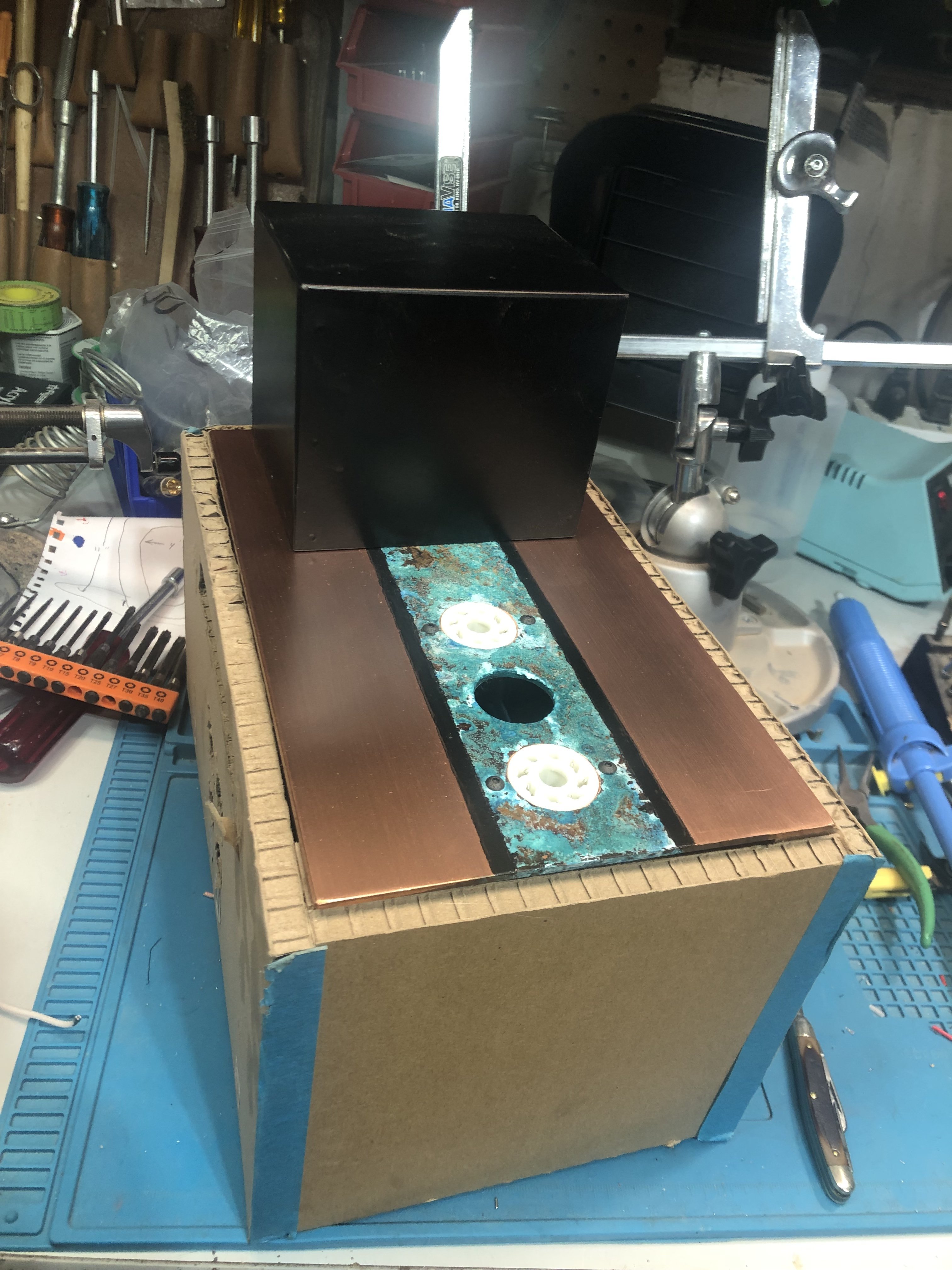

That photo got me thinking... what's the largest Schiit stack that you could do with the Modi-sized chassis now?
Throw in a Mani, SYS, Eitr, and for entertainment, a couple of Wyrds... I'm not saying it should be done, but it would be funny to see it.
As to EQ, I say good! Those of us who stick to 2-channel understand that finding a perfect room is nigh impossible. For $150 I'll pick one up eventually just to toy with and see if it makes a difference.
